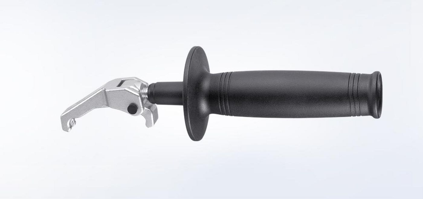

TruTool HD 1813 Griff
Sap
1 adet 2349816

TruTool HD 1813 sap
Sap
1 adet  2349816
