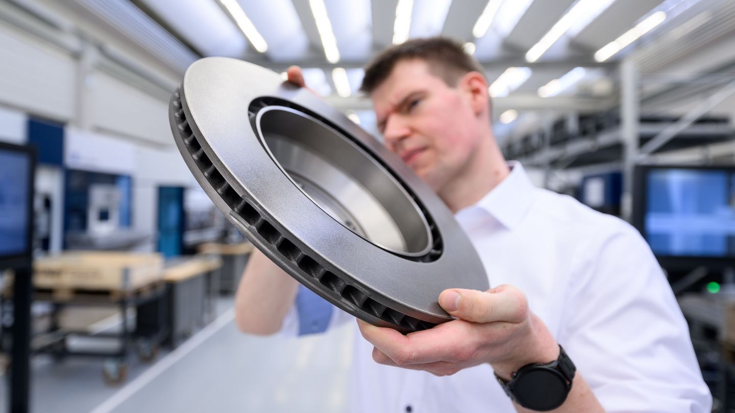

TRUMPF employee with coated brake disc.
High-speed laser metal deposition ensures less fine dust during braking and protects brake discs from corrosion.

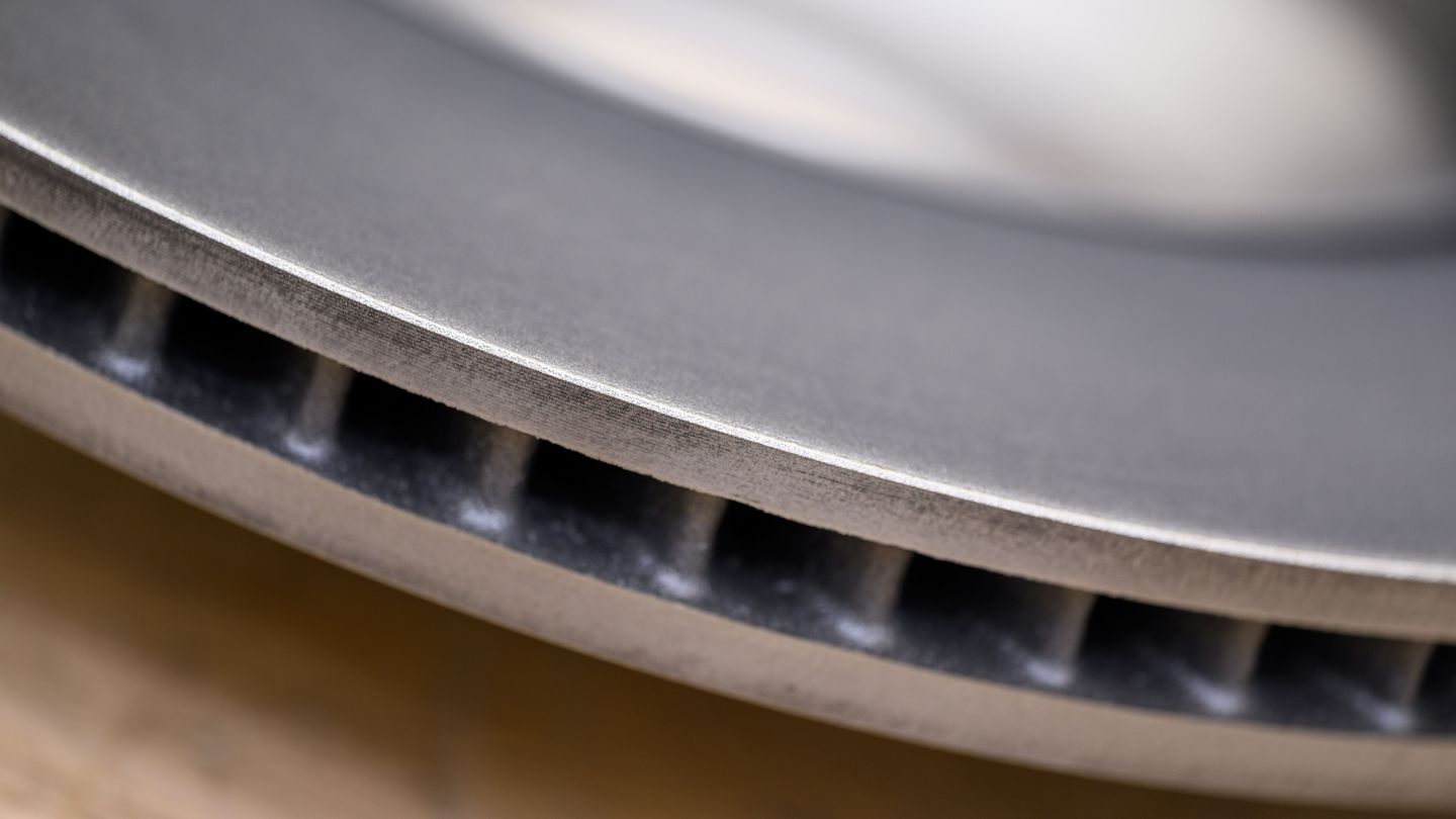

Coated brake disc
The laser process not only ensures less fine dust, but also less wear on brake discs.
