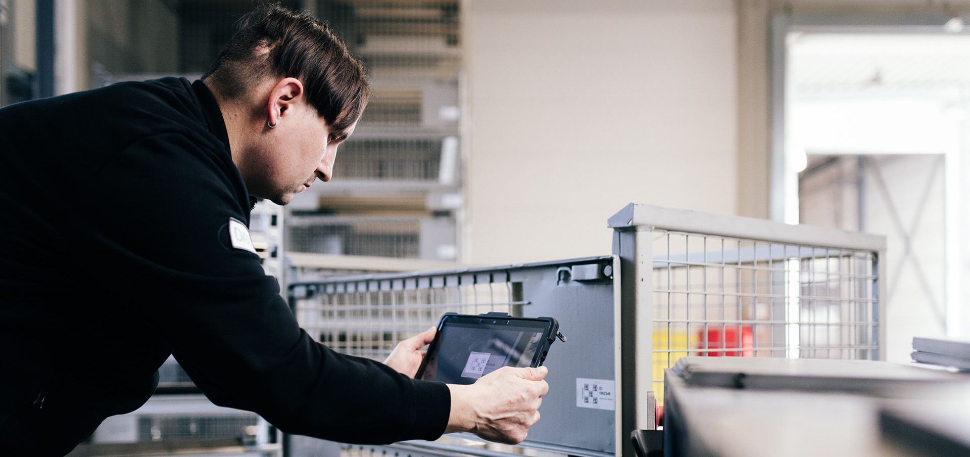

With the help of the intuitive interface of TruTops Fab Logistic, workers can check orders in and out using tablets, even on the shop floor. When an order is reported as completed, TruTops Fab automatically generates a transport order for the automated guided vehicle system. (Foto: Cornelius Bierer)

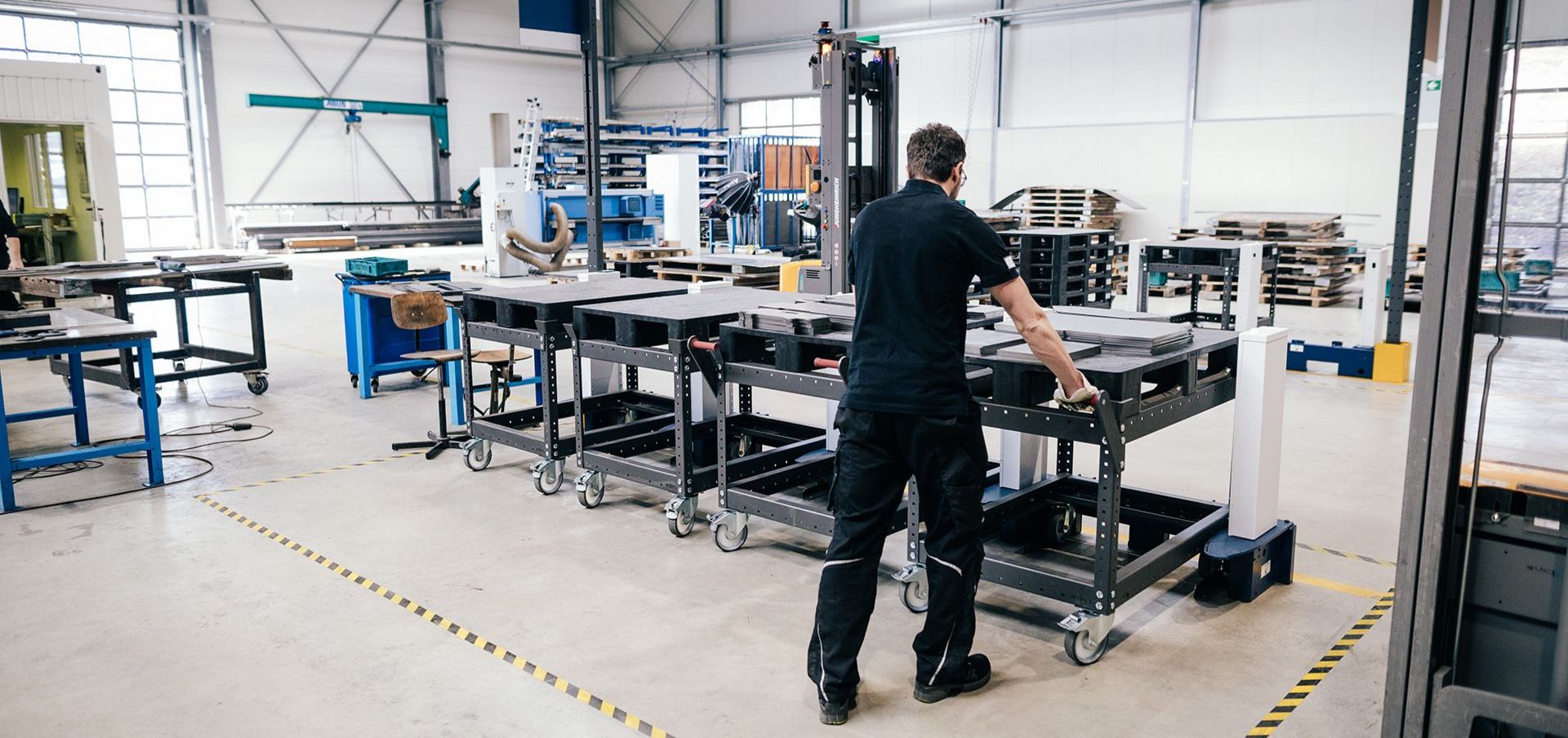

In the production sequence at a laser cutting machine, the user can now place any parts on a barcoded pallet. On an intuitive software interface on a PC or tablet, the worker "marries" the manufactured parts to the pallet using a barcode scanner. He then pushes them into a docking station. This intelligent storage station uses sensors to recognize the pallet and reports the material receipt directly to TruTops Fab. The software checks to which machine the material must be transported for further processing according to the production plan. It also checks what priority the transport has and whether there is any free space at the corresponding docking station. TruTops Fab then issues a transport order and sends it to the control system of the Jungheinrich automated guided vehicle. In addition to the advantages of automated planning, customers also benefit from automated parts transport.

Using an intuitive software interface on a PC or tablet, the worker "marries" manufactured parts to a load carrier using a barcode scanner. (Foto: Cornelius Bierer)
Sensors at the docking station detect when a pallet or pallet cage is parked and report this directly to TRUMPF's TruTops Fab software, which then takes over the automatic transport control. (Foto: Cornelius Bierer)
