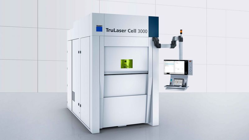

TruLaser Cell 3000
TruLaser Cell 3000

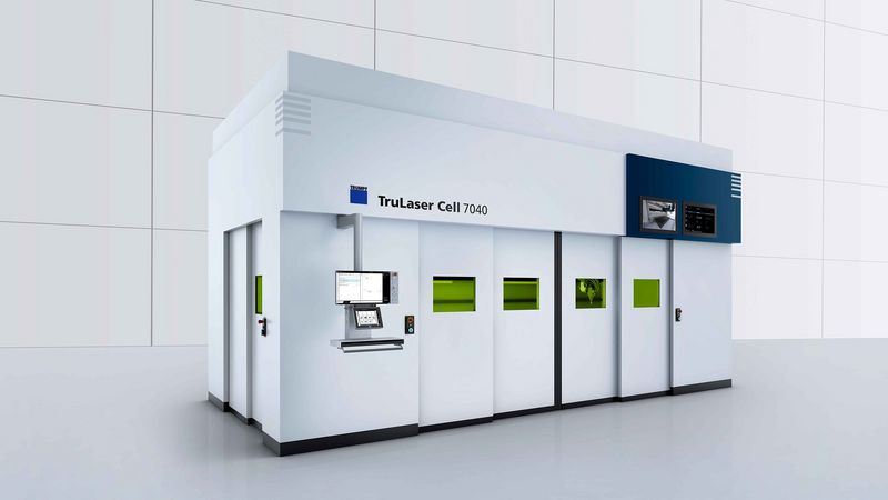

TruLaser Cell 7040
TruLaser Cell Serie 7000
