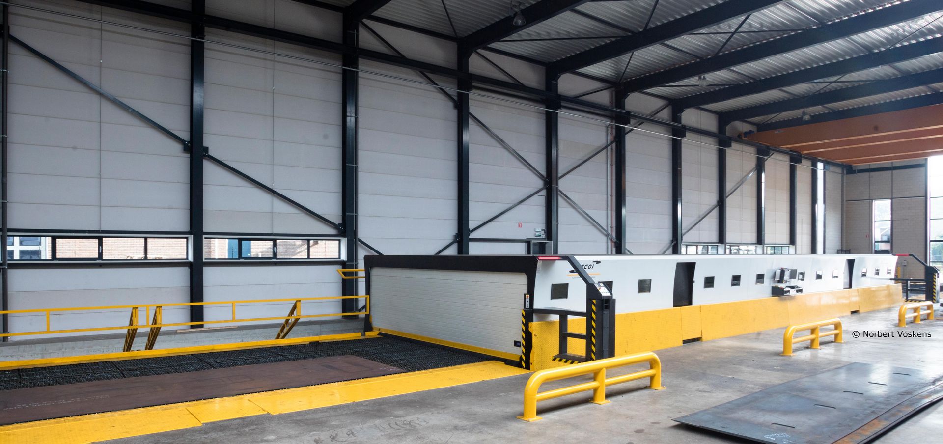

Pieter den Oudsten stands in his new factory, admiring his Spanish eye-catcher. At four-and-a-half meters wide and 66 meters long, it is the largest laser cutting machine in the world. Headquartered in Rhenen, Netherlands, M. den Oudsten Buigwerken is a specialist for leser cutting and XXL bending. The company’s laser machine cuts giant sheets and plates for truck bodies, ship hulls and buildings.
The workpieces are as large as 3 by 12 meters−and as thick as 30 millimeters. These sheets and plates lie at the ready on the 66-meter cutting table, which is recessed in the floor. A laser booth 20 meters in length travels to each of five working positions one after the other. While the machine is cutting a sheet, the operator can load and unload other sheets.
You read that right: it takes just one person to operate this gigantic machine. Because the table is at ground level, inserting sheets is easy. “Instead of having to climb onto a table, the operator can simply load and unload the sheets using a ceiling crane,” says den Oudsten. Once a sheet is in position, barriers at the sides tip up; then a booth moves over the sheet, covering it completely. Roller gates on both sides of the booth descend−and cutting can begin.
66 Meters – a table this long is perfect for even the largest sheets, and it also creates space for loading and unloading while the machine is cutting (Photos: Norbert Voskens).

Two cutting heads dance across the sheet, cutting the specified shapes. Both of these optical systems are mounted on a single portal that moves over the sheet in the direction of cutting. As soon as a sheet has been cut, the roller gates ascend and the booth moves on to the next sheet. “This approach allows us to cut five or even ten sheets in one go, depending on sheet size.”
