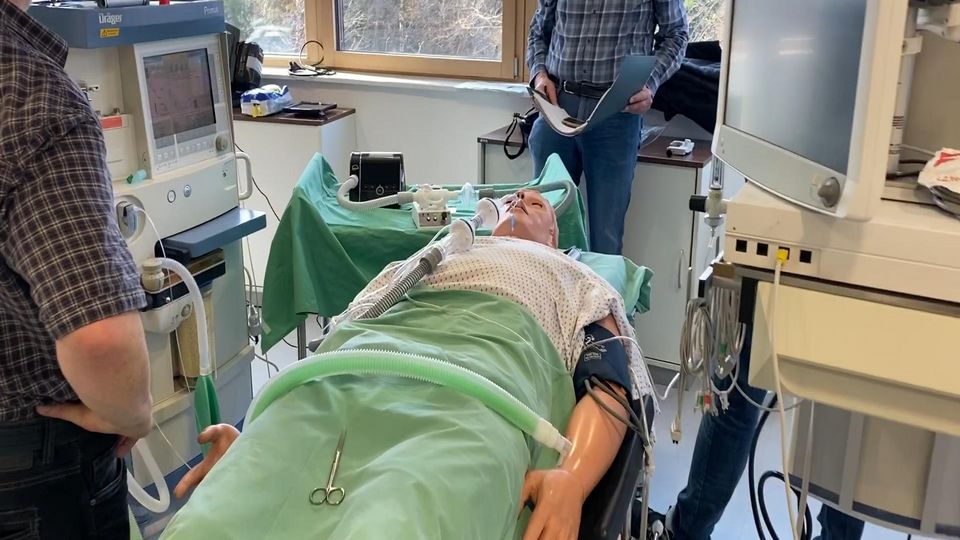

Researchers and medical professionals from the University of Marburg use a dummy to test the ventilator. (Source: University of Marburg)

The converted CPAP machines are not suitable for acute coronavirus cases with extreme breathing difficulties. However, patients can switch to them after only a few days of treatment. In the best case scenario, this can ease the shortage of conventional machines, which can then be used exclusively for emergency treatment. In addition, the researchers are aiming to develop a second machine in cooperation with local companies which can be manufactured in the traditional way. This would mean that individual manufacturers could mass-produce the machines in larger batch sizes.
