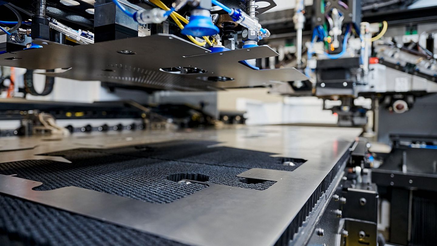

Running in the TruMatic 5000
Running in machines manually costs companies time and money. TRUMPF’s digital run-in assistant speeds up this process with the help of AI (source: TRUMPF)

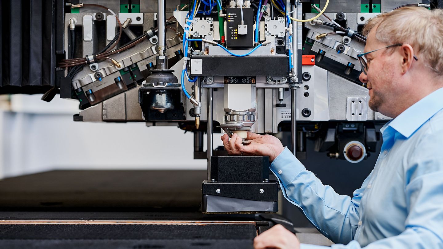

Removing parts
TRUMPF’s digital run-in assistant automatically determines which parts require manual set-up. For example, the solution calculates a part’s bending angle during removal (source: TRUMPF)
