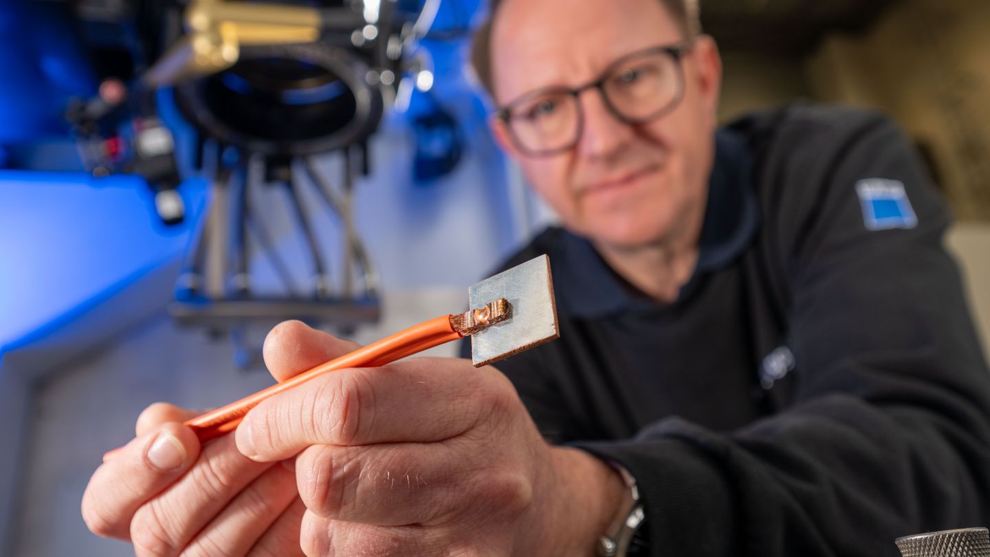

The new laser solution creates a firmly fused joint with low electrical resistance, thereby making the power electronics more efficient. The process is primarily intended for use in the manufacture of voltage distributors in electric and plug-in hybrid vehicles. These components distribute the high voltage from the vehicle battery to the electric motor, lighting and other electrical consumers, and are fitted in every electric car. Until now, manufacturers have had to produce conventional mechanical connections for voltage distributors in several process steps. This is time-consuming and can lead to errors. Furthermore, mechanical screw connections are susceptible to vibrations and exhibit higher electrical resistance. This leads to energy losses and additional heat generation.

TRUMPF’s new laser solution enables more efficient power distributors in electric vehicles. (Image: TRUMPF)

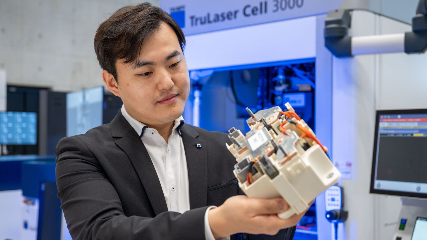

Exemplary laser-welded voltage distributors for PHEVs and BEVs
(Image: TRUMPF)
