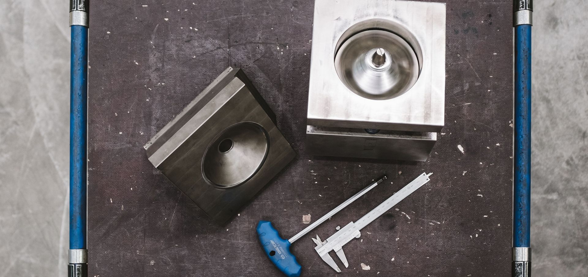

It took some time for the fully automatic bending cell TruBend Cell 5000 to be completely integrated into production at PNH Kft. in Vasvár in Hungary. This had nothing to do with the machine itself, but rather resulted from the highly particular applications for which CEO Martin Mitterhumer wanted to prepare the bending cell: "Our boiler plate manufacturing process at the plant operates on a very large scale, and we wanted to use the TruBend Cell 5000 to automate the rigging of the semicircular, bowl-shaped depressions required for this process". It turned out to be a real challenge: the depressions have a diameter of 120 millimeters and, at a sheet thickness of five millimeters, the sheet metal warped while it was being reshaped. Ultimately, the special tools developed by TRUMPF in Pasching especially for the client provided a solution. And our joint efforts paid off. Mitterhumer: "Before, we were battling with a terrible handling process and had to assign two employees for this. But now we can relieve the burden on our personnel and save a great deal of time."

For boiler plate production, half-shell-shaped recesses must be made in the plate. First a hard nut for the TruBend Cell 5000. Today, the bending cell handles the forming process fully automatically, saving a lot of time.
 – Stefan Fuertbauer
The special tools developed by TRUMPF in Pasching especially for PNH, enables to automate the rigging of semicircular, bowl-shaped depressions required for the boiler plate manufacturing process.
