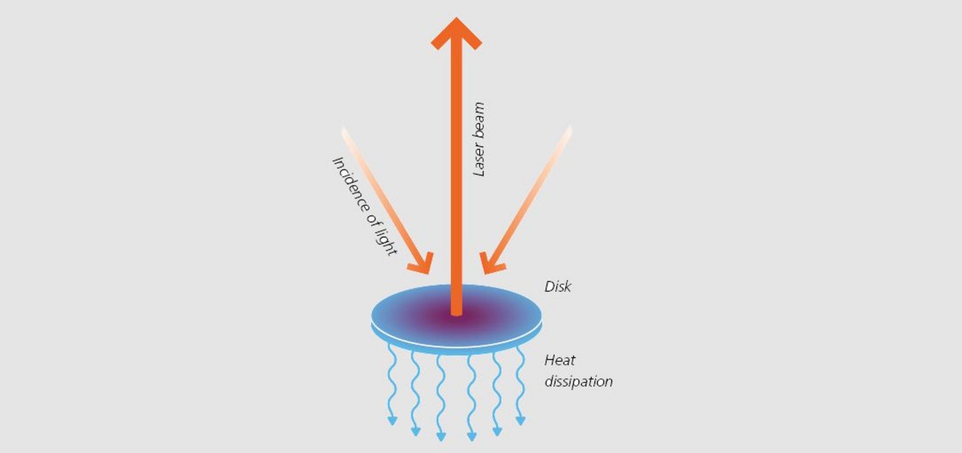

Yes, the idea of a disk just came to me on the plane. Because a disk that was thin enough would be particularly easy to cool across its whole area. That was the basic idea at least, and my team and I then spent the next three months developing a concept that essentially looked much the same back then as it does today.
Could you briefly explain how it works?
Well at its core, as I said, is a Yb:YAG disk that is just about a few hundred micrometers thick—the surface area to volume ratio solves the cooling problem. What’s more, the direction of the temperature gradients is almost exclusively axial, which results in minimal thermal lens effects. The laser medium is pumped in a multipass configuration that consists of a parabolic mirror and a deflection system. It actually sounds relatively simple, but the technology is highly complex. The pump beam is refocused by a mirror into the laser crystal.
The highly reflective coating on the back of the disk reflects back any non-absorbed radiation. Repeat that enough times and you get highly efficient absorption of the pump light, and the pump source doesn’t even have to be particularly brilliant for the disk laser to exhibit good beam quality.

You’re right that cooling has always been the key issue. It really does go hand-in-hand with any attempt to boost the laser power. A disk laser features less thermal deformation in real-life operation than a traditional laser by a factor of around 100.
But there’s more room for optimization even in that area. For example, there are publications from the U.S. on liquid nitrogen-cooled lasers. And we have already shown that temperatures between -30 and -100 degrees Celsius lead to significant improvements. But it’s difficult to imagine those kinds of cooling systems in an industrial setting.
Because the disk is thin with a large surface area, heat dissipates quickly—often even passively via a heat sink.
