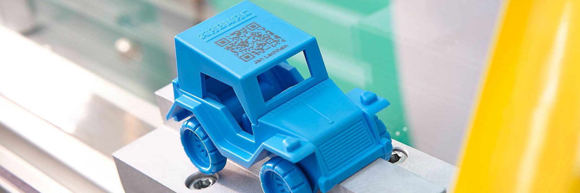

ARBURG demonstrated exactly what this interplay of database, machine, quality assurance and marking looks like in spring 2014, also at one of the company’s open house events. Using a custom chip card, visitors were given the chance to have the parts for a toy buggy made. Before leaving the manufacturing cell, the roof of each future buggy was given a laser-marked QR code. At the same time, the machine control system deposited all manufacturing parameters in the ALS database and assigned them to the relevant code.
The Laser Which Does Not Call for Your Attention
Once visitors had assembled their buggies, an automated quality assurance system checked and documented the result. Using the QR code, the ALS then immediately matched the results to the right buggy.
