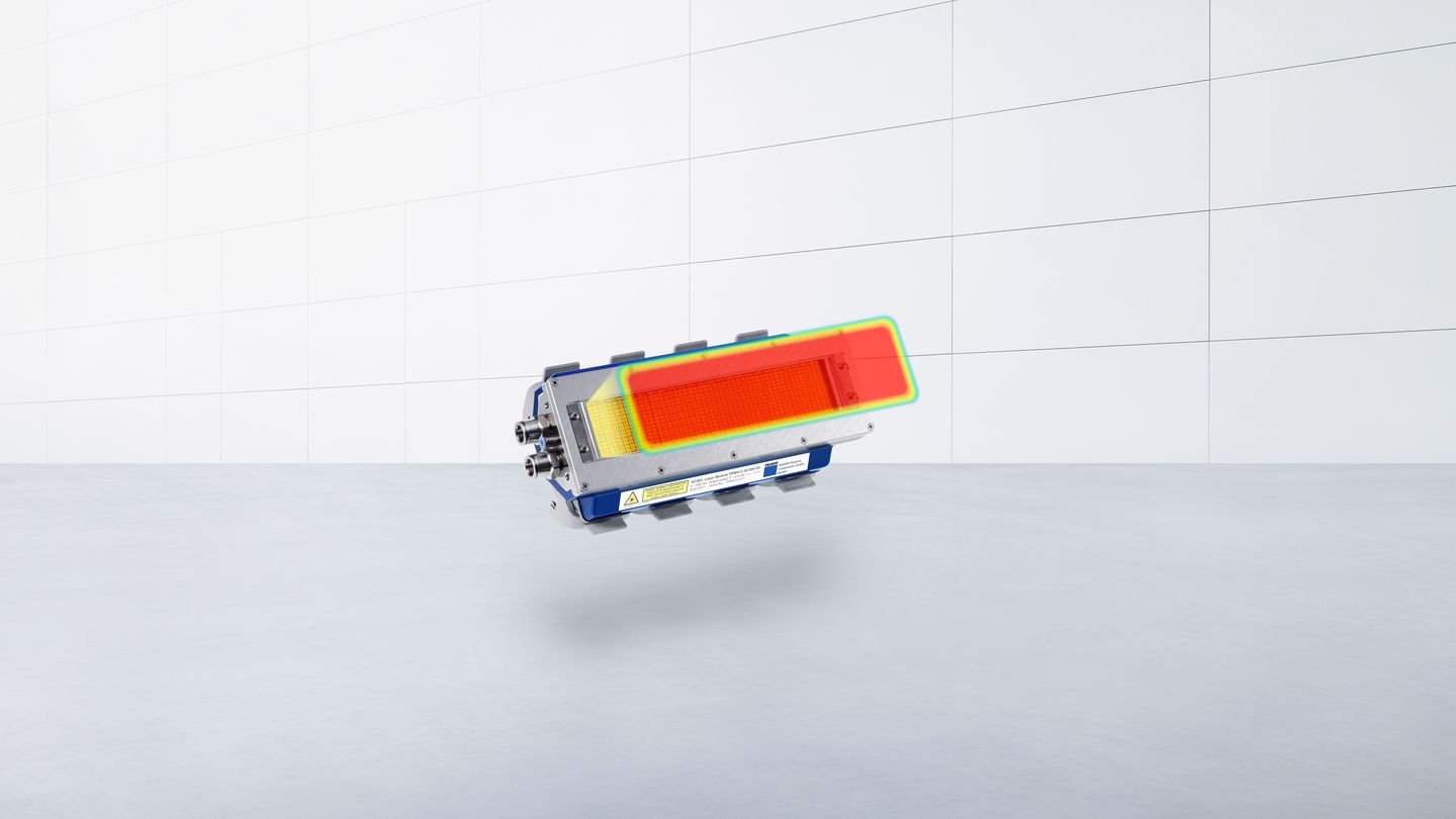

Laser solutions from TRUMPF for Li-battery manufacturing enable a more efficient production in various process steps. © TRUMPF

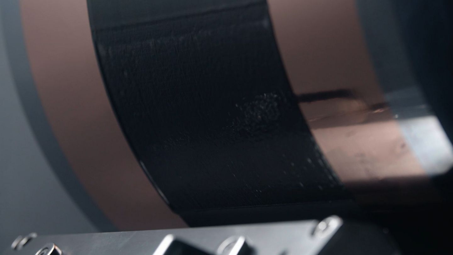

At the process step of battery foil drying, VCSEL heating systems efficiently dry the active material on the electrode without any energy loss, thanks to direct heat treatment. © TRUMPF

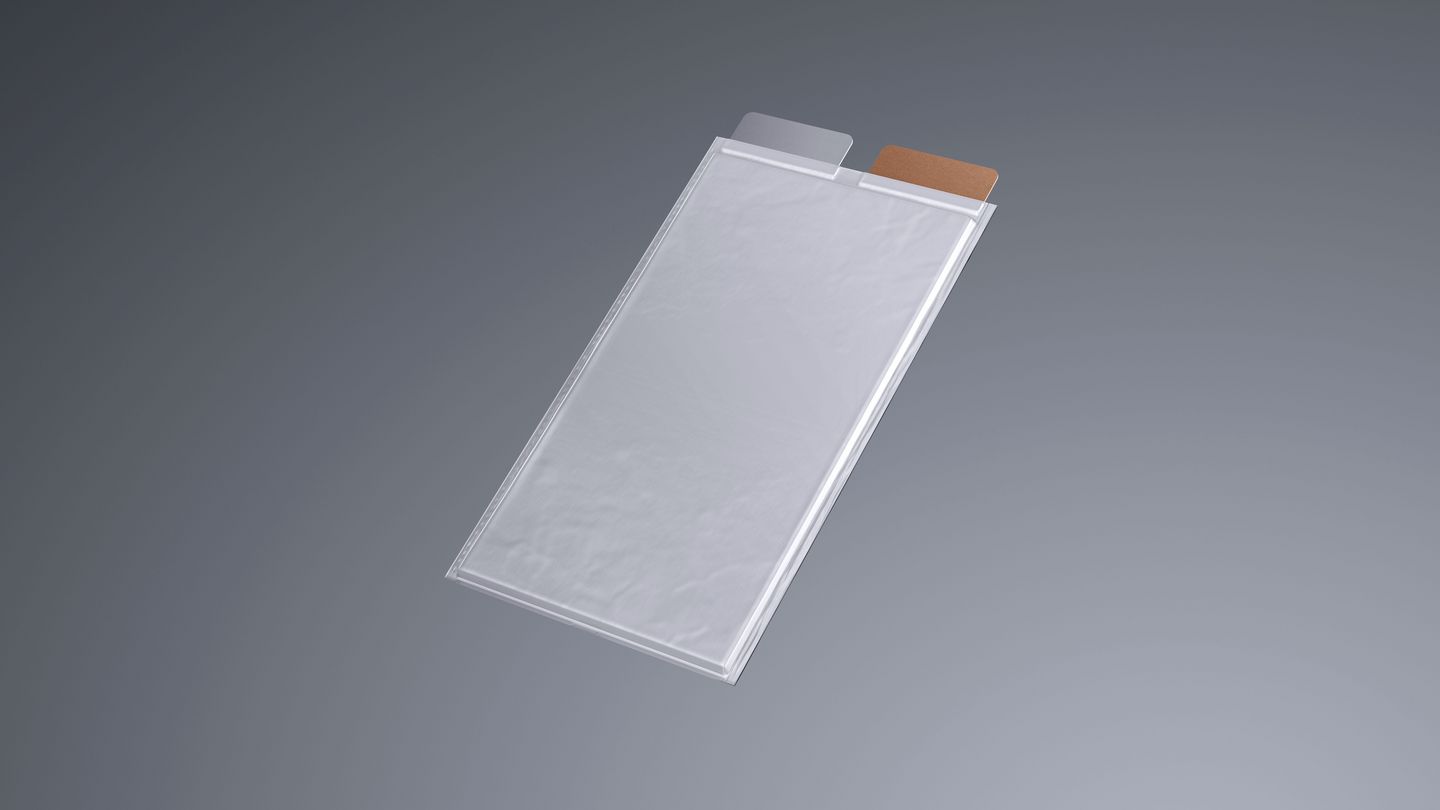

At pouch cell manufacturing VCSEL heating systems achieve higher quality and faster process times at welding the foils. © TRUMPF
High-power infrared VCSEL heating systems provide scalable power and can be regulated precisely. © TRUMPF
