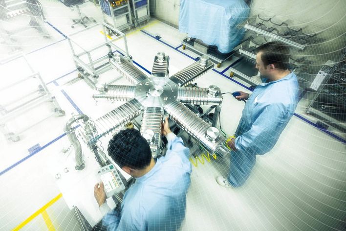

Intelligent production means: the machine finds out for itself what to do. (Picture: Detlef Göckeritz / Gernot Walter)
For this to work, the production needs highly flexible, easily controllable tools. (Picture: Jens Oswald / Gernot Walter)
