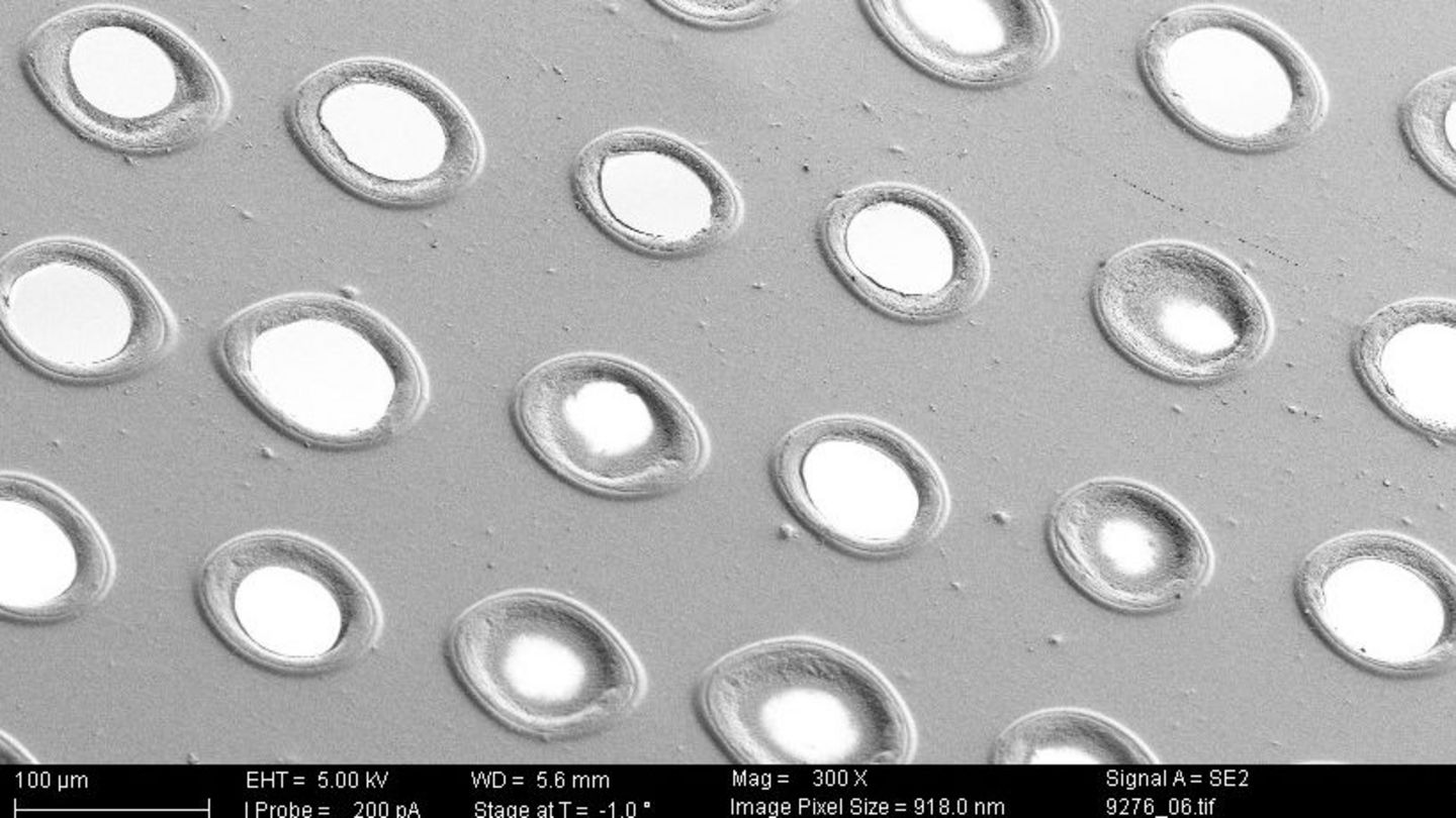

Processed separator foils with VCSEL heating systems
VCSEL heating systems are used to irradiate a printed micro pattern on electrode foil. The IR laser is absorbed only on the printed pattern and creates micro holes with a diameter of 3 – 22 μm through the substrate.

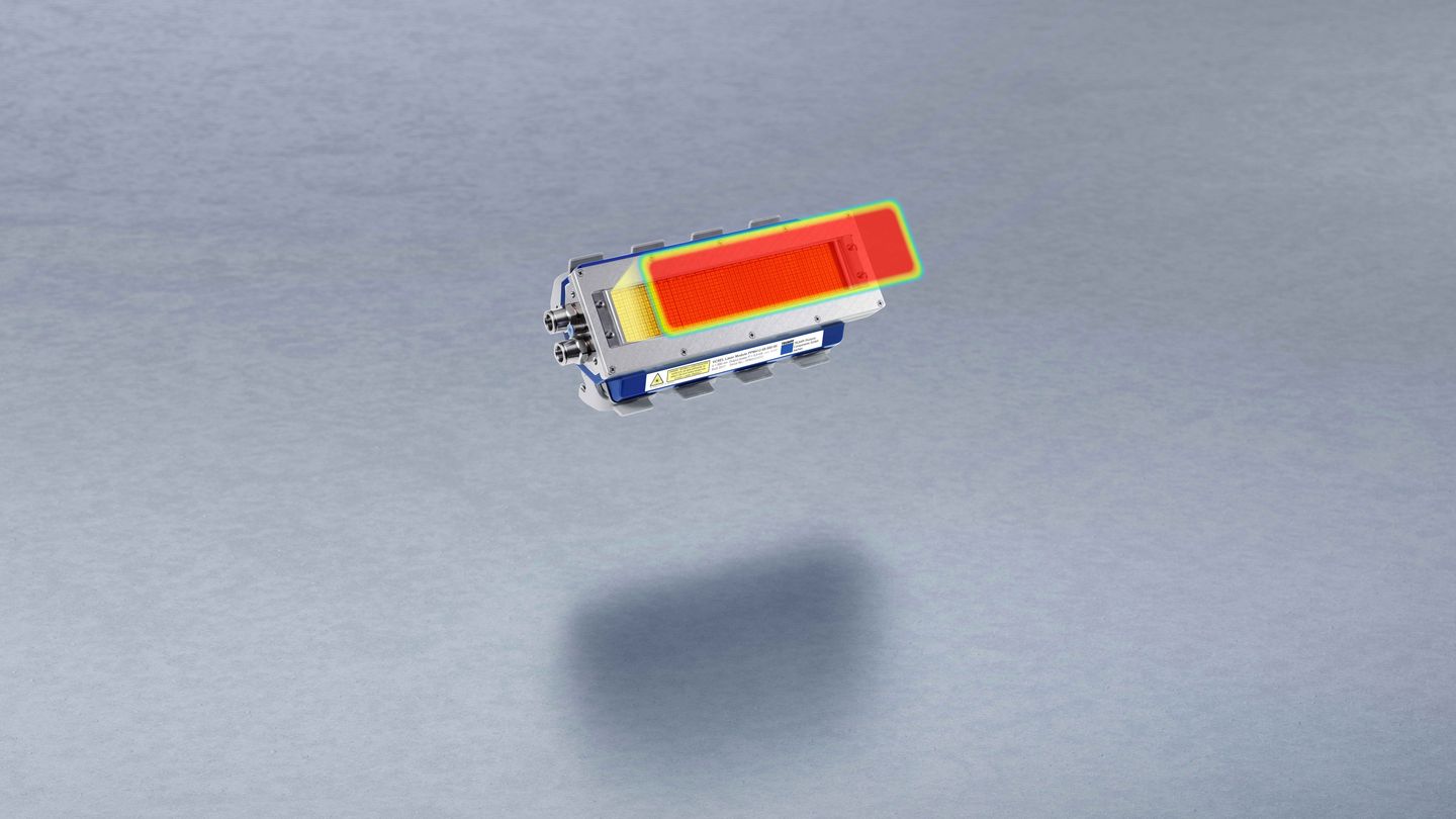

Laser heat treatment with VCSEL-based systems offers highly accurate solutions for a number of process steps, such as perforating, drying, sealing and joining.
