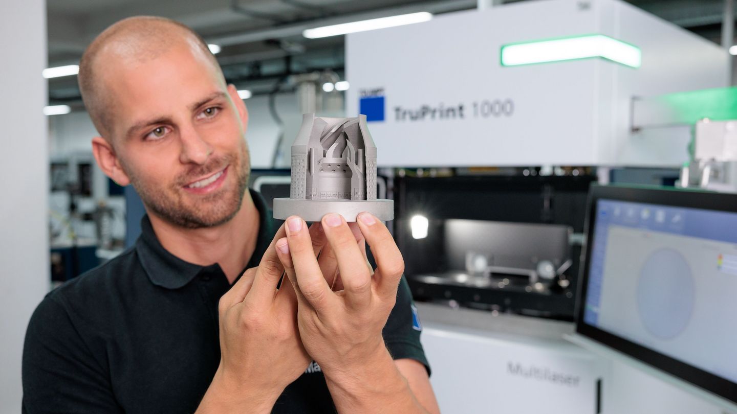

“Users from any industry can benefit from the ability to 3D print parts without supports. The advantages of support-free printing are particularly appealing for parts that feature large cavities or challenging overhangs,” says Degen. Examples include tanks, heat exchangers, hydraulic blocks and tool molds.
The new technology also opens up new applications that couldn’t be properly exploited when support structures were still necessary, including areas such as additively manufactured radial compressors and shrouded impellers. Previously, manufacturers were unable to print support-free impellers due to their overhang angles. “The need for supports meant that 3D printing wasn’t an economically viable alternative to conventional manufacturing. But now things are different,” says Degen.

The advantages of support-free printing are particularly appealing for parts that feature large cavities or challenging overhangs.
