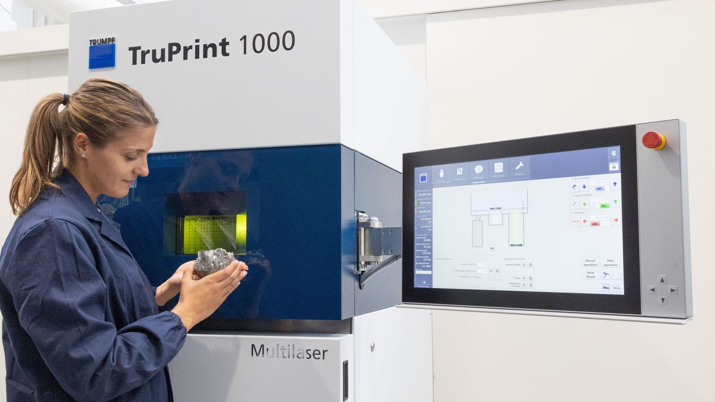

TruPrint 1000 ready for series production
The system is particularly easy for the user to operate. This shortens production time. (Photo: TRUMPF)

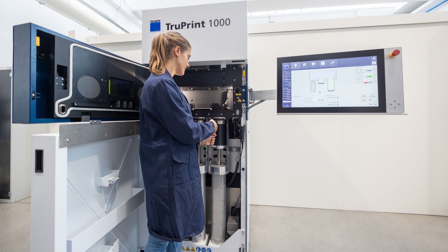

Compact design
At just about 80 centimeters wide, the machine takes up little space and fits through a standard door. (Photo: TRUMPF)

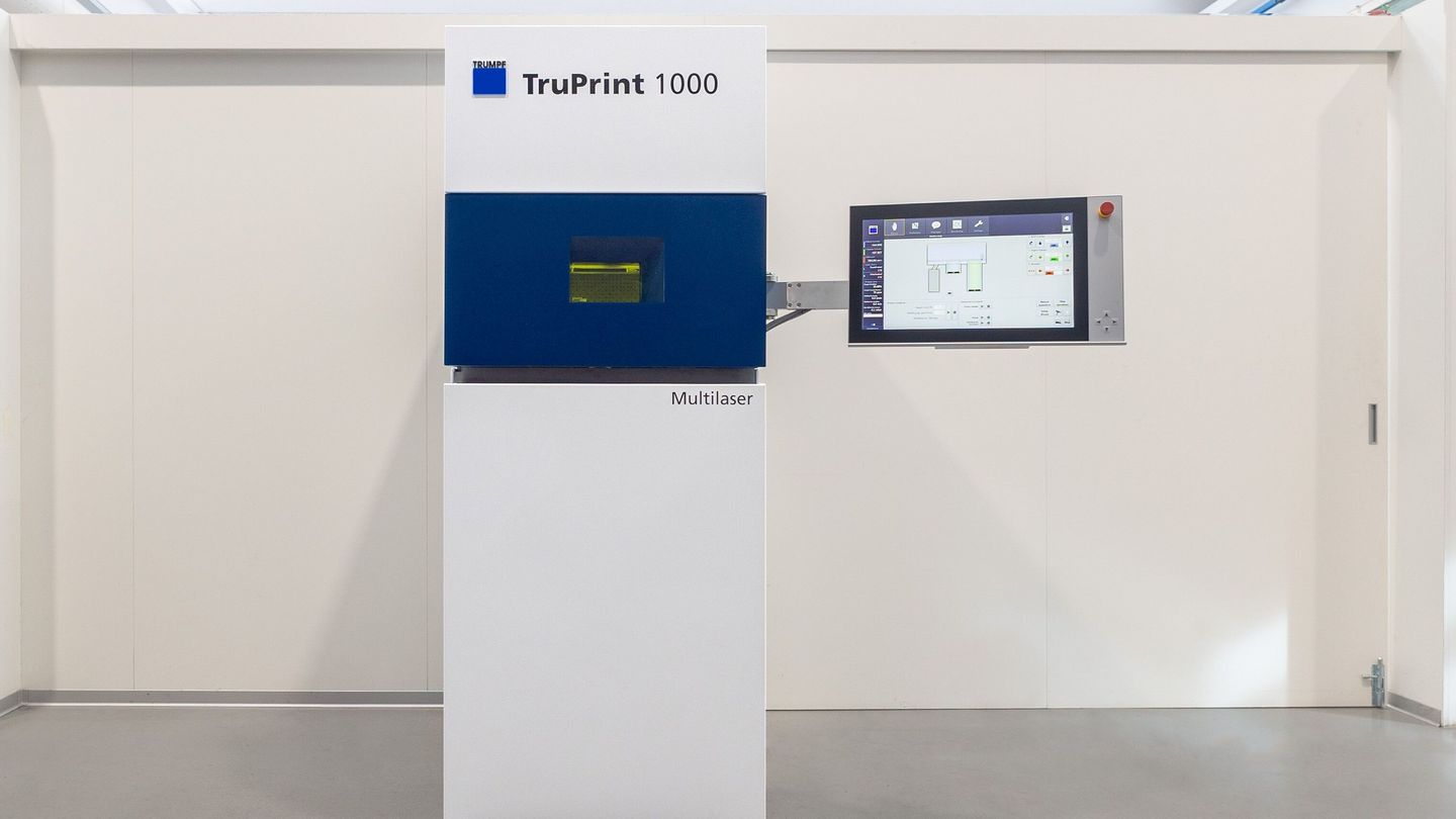

Suitable for many applications
With the TruPrint 1000, users can additively manufacture dental prostheses or medical technology, for example. Many other applications are possible. (Photo: TRUMPF)
