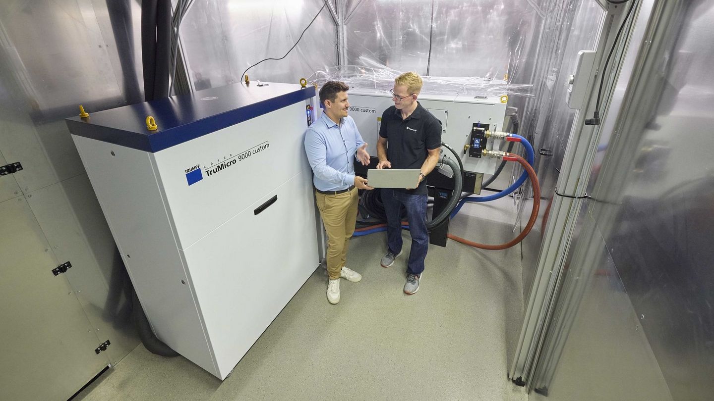

Steffen Rübling, TRUMPF (left), and Dr. Dennis Haasler, Fraunhofer ILT, discuss details of the operation of TRUMPF's 1 kW UKP laser. The Fraunhofer Institute for Laser Technology ILT in Aachen has already systematically explored the potential of the beam source with 1 kW average power. (Image source: Fraunhofer ILT, Aachen / Ralf Baumgarten)
