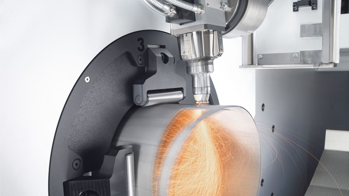

At the heart of the machine is a four-kilowatt TruDisk 4001, a high-power disk laser manufactured by TRUMPF itself. The beam source is robust and reaches the high cutting speeds typical of solid-state lasers. Moreover, the RapidCut function further increases productivity. By superimposing the movements of the tube axis and cutting head, TRUMPF design engineers have achieved a fourfold increase in machine dynamics. As a result, the high feed rates of the solid-state laser are noticeable even in small contours. Meanwhile, PierceLine speeds up the piercing process. This option is just one function that TRUMPF has transferred from sheet to tube processing. The developers have also drawn on expertise from laser flatbeds for the cutting data. All in all, the TruLaser Tube 7000 fiber processes tubes and profiles faster than its CO2 laser cousins. "Taking the typical mix of parts worked by our customers, we increase productivity by 15 percent - thanks to solid-state laser technology alone. Depending on the part geometry, RapidCut can substantially increase this percentage even further," says Karl Schmid, Head of Product Management for Laser Tube Cutting.

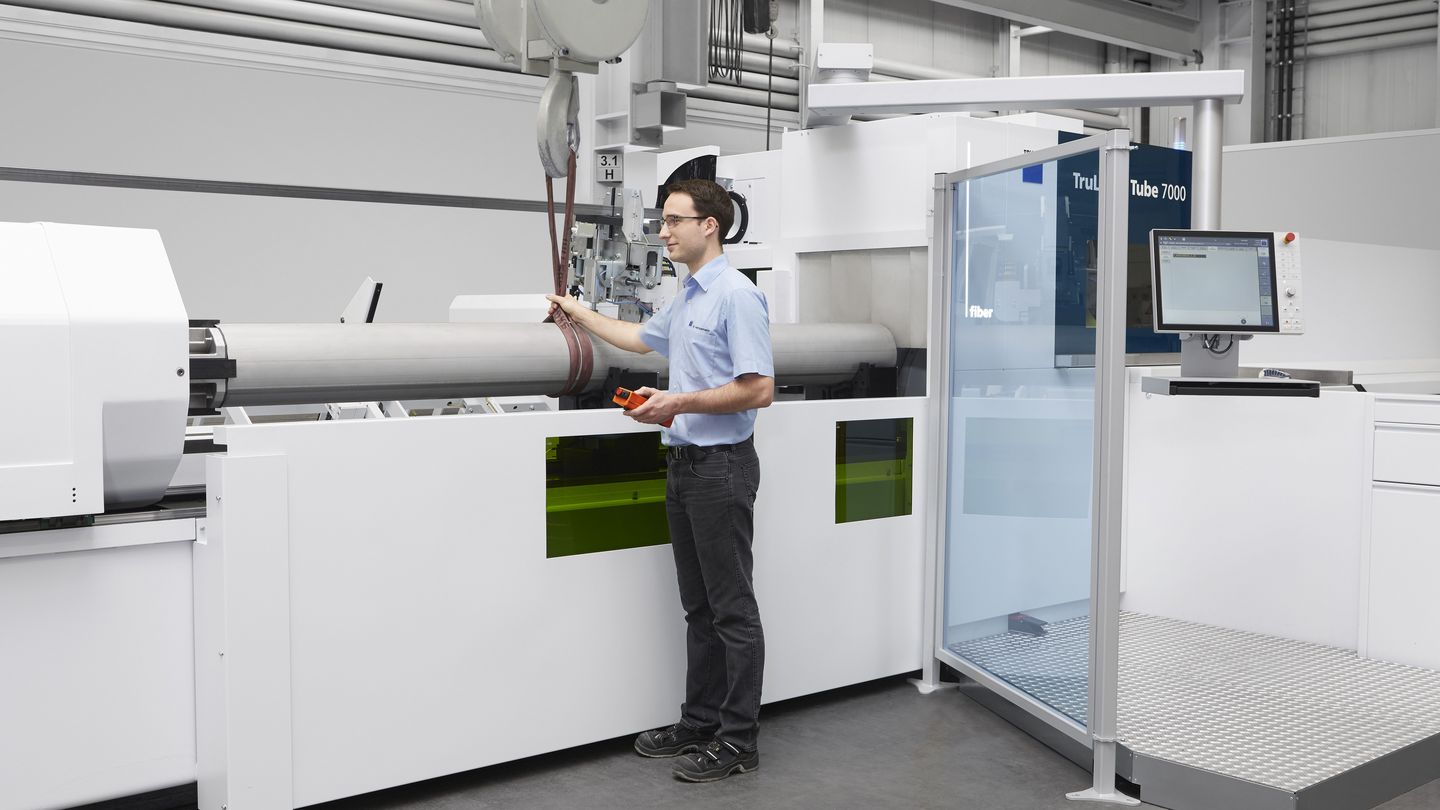

Laser safety is always important - particularly for machines with solid-state lasers. The beam guard for TruLaser Tube 7000 fiber is designed to give the operator unrestricted access to the loading and unloading side of the machine. "Our cleverly designed and technically sophisticated beam-protection solution provides Class 1 laser safety," says Schmid. "At the same time, the operator can easily access the loading and unloading side as well as the work area. He can also use a crane to freely load large tubes individually."

With LoadMaster Tube, the TruLaser Tube 7000 fiber system is capable of fully automated operation. The loading unit's tube magazine holds up to four metric tons of raw materials. LoadMaster Tube performs all the necessary settings automatically, which reduces setup times. Before loading, software compares the geometry of the tubes and profiles with the data stored in the control system, thereby ensuring that the right material has been loaded. A gripper system transfers the tubes from the magazine to the machine. Collet chucks position and hold the tube while handling the material gently. Sensors monitor the clamping system and ensure that it adjusts automatically to each tube geometry and profile geometry. For small-scale series and special profiles, the operator can use the swivel-mounted conveyor system, which also loads the machine automatically. In addition, individual tubes can be loaded manually at any time. While finished parts are being unloaded, sensors test whether the machine has discharged them correctly. According to requirements, conveyor tables transport the parts directly in wire mesh boxes or in containers - sorted, if necessary. In automatic mode, the operator can take the finished parts off the conveyor tables at an ergonomic working height.
