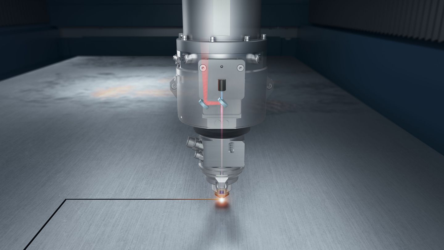

Active Speed Control is the first step on the road to autonomous laser cutting. Machines equipped with this cutting sensor system can automatically control and monitor the cutting process. A camera looks straight through the cutting nozzle right into the kerf in real time, observing the light emitted during the laser cutting process. Changes in the amount of radiation emitted show whether the molten material is being properly ejected from the kerf. Based on this data, Active Speed Control automatically adjusts the feed rate as necessary to ensure that the machine is always cutting at the optimum speed. This balances out any fluctuations in process reliability and reduces the number of rejects in the production process.

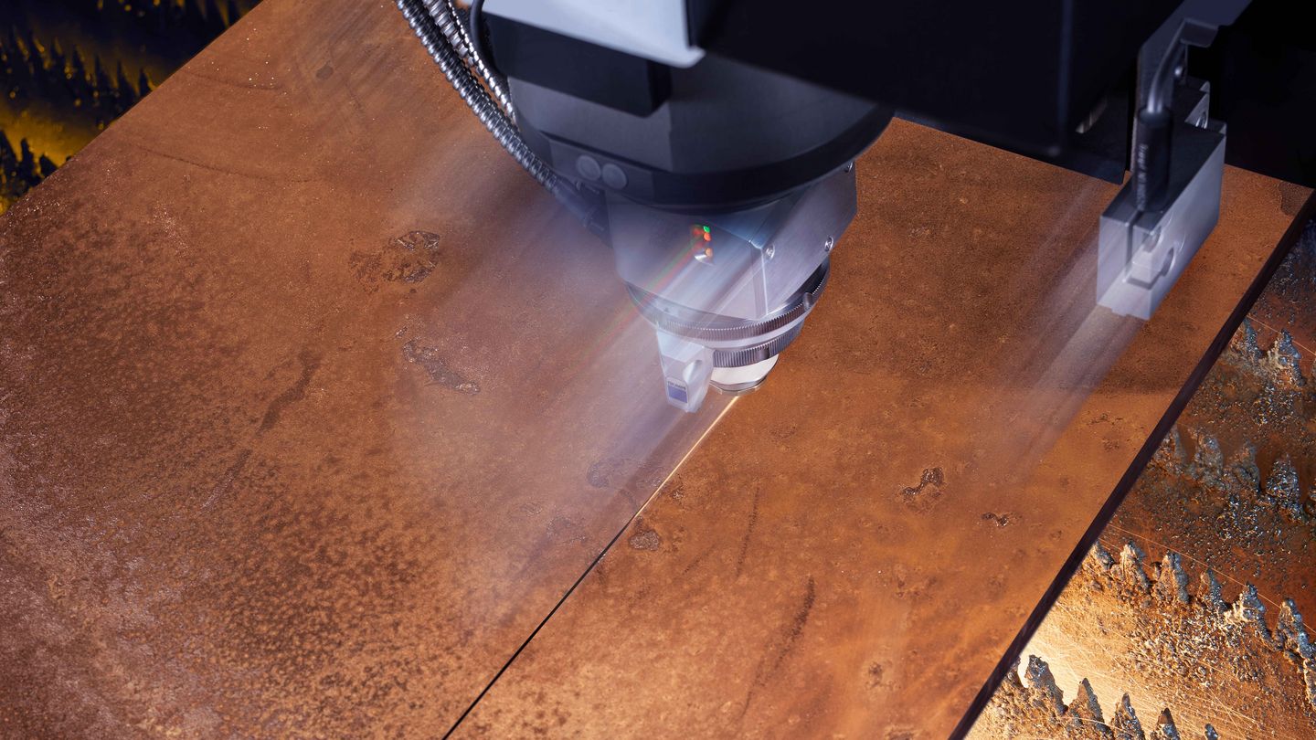

Another helpful feature for cutting thick material is the CoolLine nozzle, which sprays water onto the workpiece around the laser beam to cool the metal. This prevents heat from building up and negatively affecting the quality of the cut. This cooling function allows users to fit more parts on a single sheet and cut delicate parts more reliably.

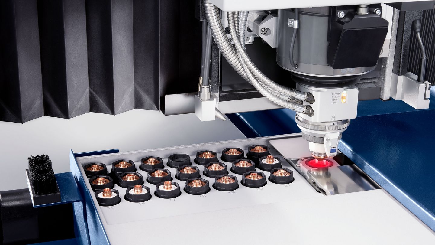

4. Automatic nozzle inspection
Smart Nozzle Automation makes life easier for operators by guaranteeing reliable, burr-free cutting. The system switches to the right nozzle and checks it for wear even in fully automated operation. Users can remove the nozzle changer from the machine and set it up even during cutting. This helps minimize non-productive time.

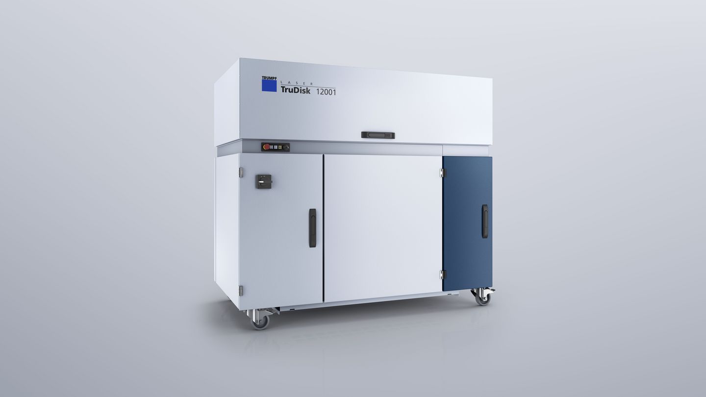

TruDisk 12001
The TruDisk 12001 is a disk laser and offers 12 kilowatts of laser power. (Source: TRUMPF)

Cutting Head
Cutting head with Active Speed Control and camera. (Source: TRUMPF)
CoolLine
The selective cooling of the workpiece during the cutting process allows new geometries in the processing of thick mild steel. (Source: TRUMPF)
The nozzle changer automatically exchanges nozzles and mounts the right nozzle via program control, while pallet change is taking place. (Source: TRUMPF)
