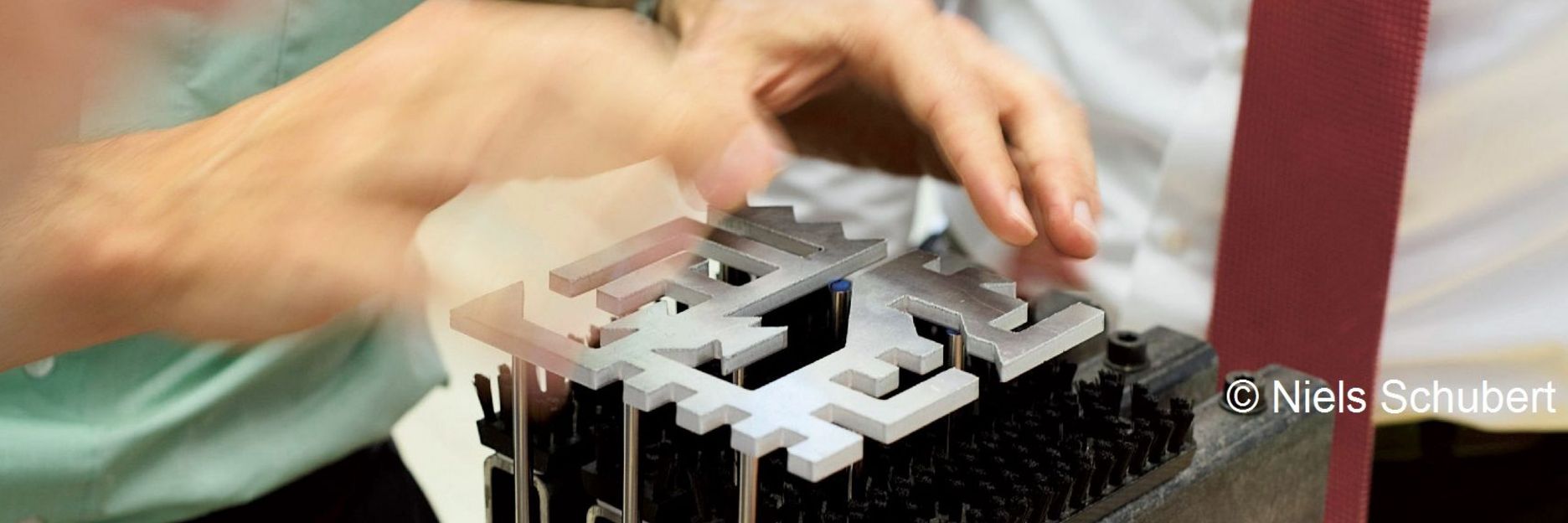

Epperlein: There are essentially three core innovations that make the machine unique. First there’s the flat workpiece support with the SmartGate, which adjusts flexibly during the cutting processto widely varying parts, and machines them extremely quickly and reliably. Then there’s the SmartLift, with its more than 150 pins, which achieves extraordinary removal forces of up to one ton of parts from the scrap skeleton. And to complete the picture, there’s the SortMaster Speed, which absorbs these forces in a controlled manner and, with its more than 2,500 mini suction devices, quickly and reliably unloads all kinds of parts, from those with delicate contours to those with large surface areas. This makes the TruLaser Center  7030 the first 2D laser machine that can handle – and automate – the entire machining process. From loading and cutting to unloading and sorting finished parts, everything is integrated in a single machine, and the program is largely automated.
