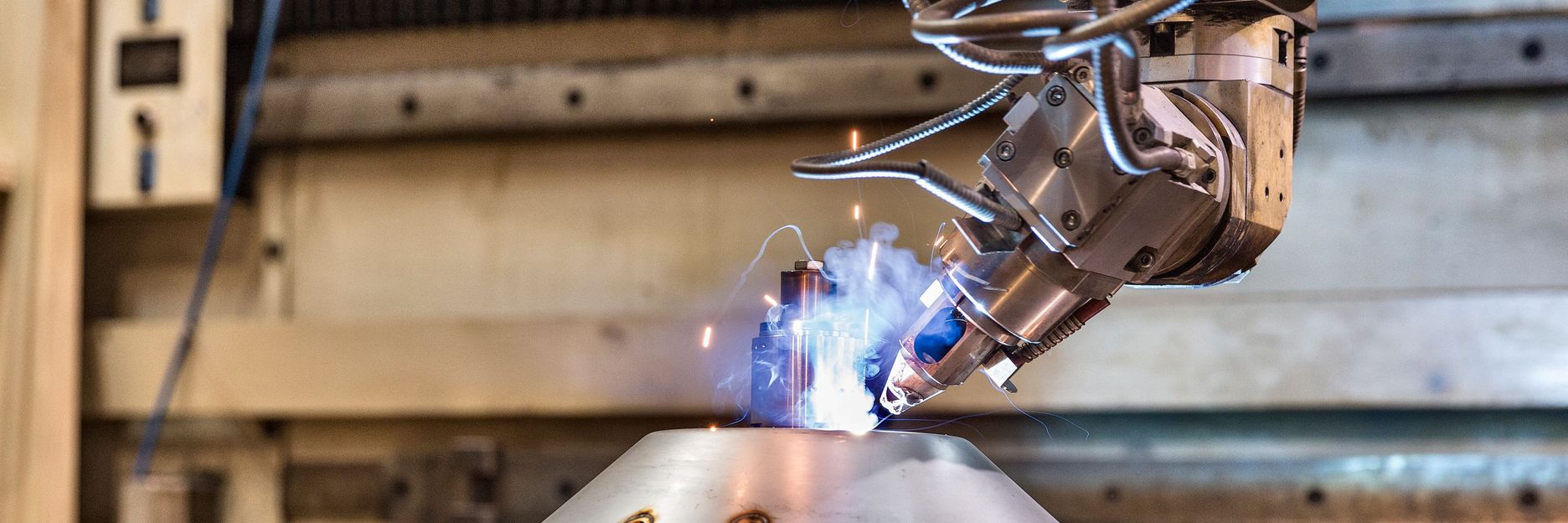

Once he’s reached the laser system, he introduces his current project. “Here, we’re in the process of manufacturing an impeller.” However, there is not much to see. Laser optics move to and fro – and only on closer inspection can we tell that gradually, layer by layer, an object is emerging. “LMD,” says D’Alonzo in a word.
Data to forms
The abbreviation “LMD” stands for “laser metal deposition”, also known as laser cladding; it is the name given to a process in which metal powder and laser light are used to manufacture workpieces. In this process, a laser generates a melt pool on a base structure and simultaneously causes powder delivered via nozzles to be fused into beads.
ELFIM is using a nickel alloy powder for the impeller.

“Strictly speaking, LMD is actually nothing new. It’s a process that has been used for many years now for repairs and coatings. However, we decided to use the process for manufacturing complete components – as is the case with this impeller here.”
