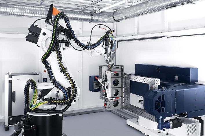

In its own productions of laser light cables TRUMPF welds protective caps using femtosecond lasers. The process is ready for industrial use.
Lateral view: Laser-welded protective caps are more than twice as strong as conventionally joined caps in breakage tests.
Laser-welded protective caps for laser light cables
Glass components that were previously glued to each other can now be economically welded with high-quality results, as TRUMPF has demonstrated in its own production of laser light cables. Until recently, the lids of the protective caps for the laser light cables were glued on. Now, lasers are used to weld them on. The joint strength of the glass parts depends primarily on the level of pulse energy. The pulse energy for 1030 nanometer infrared light needs to be 9 microjoule.
TRUMPF is currently building a laser-welding system for reliable glass welding for mass production of the protective caps for the laser light cables in its own production plant in Schramberg. Elke Kaiser states, “The laser system also serves as a pilot system to demonstrate to potential users that new, innovative laser methods are reliable and ready for deployment in glass processing and offer immense advantages.”
