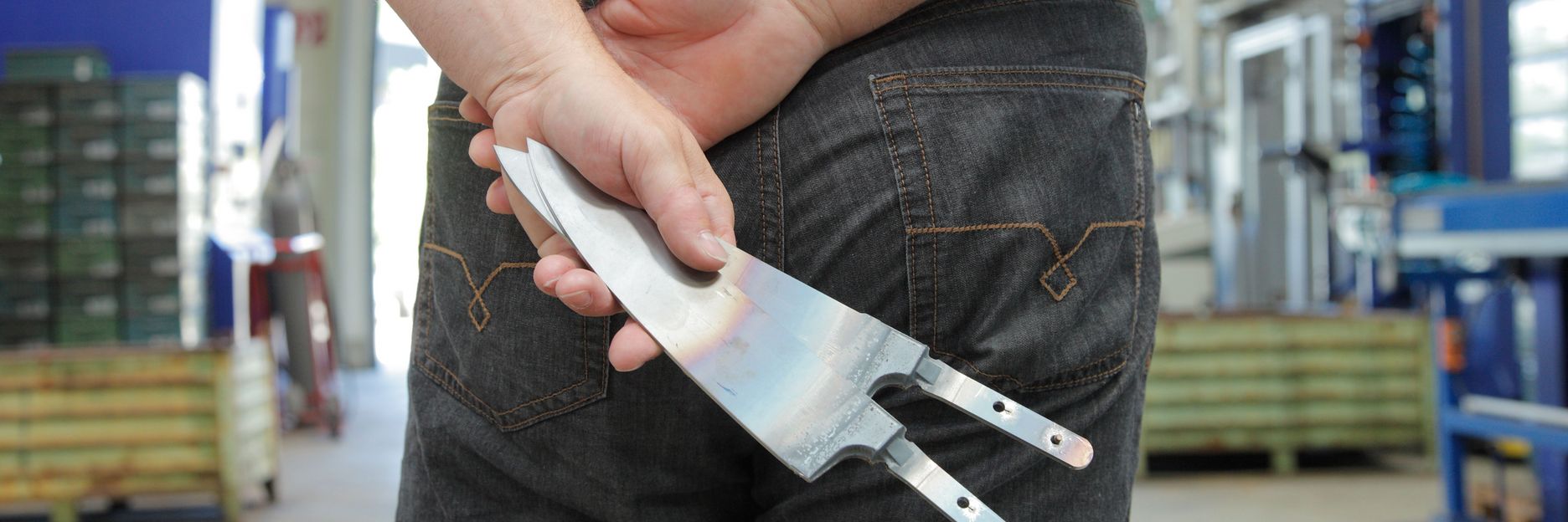

This will be a knife: the screw press has forged the glowing bead into a bolster. Now the workpiece lies on the cooling section. Two fans are cooling it evenly from above and below by 1,000 kelvin to 200 degrees Celsius in just three minutes – without stresses or structural changes.
The molded gripper forces the blanks into a defined position, aligning them with the laser machine’s reference system.
Following contour cutting, the blades wait for pins to be fitted and then go for grinding and hardening.
