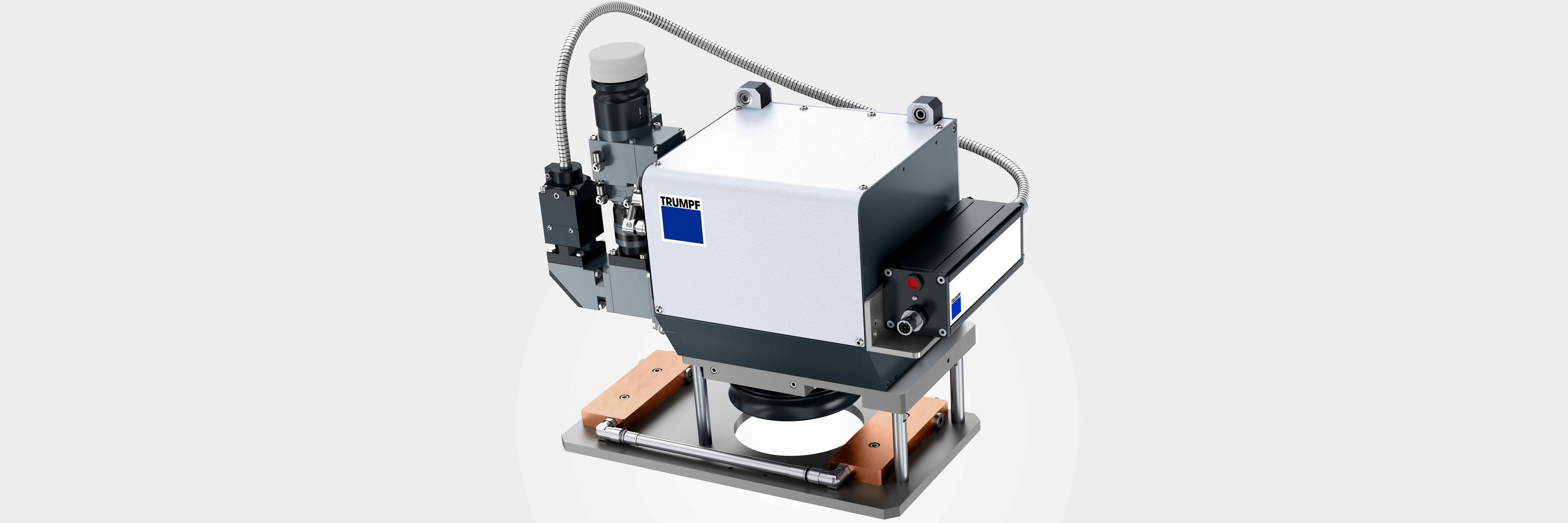

During plastic welding and laser-based surface processing - such as surface hardening - every degree counts. Differences in material, geometry, or fluctuations in laser power can affect the temperature distribution in the process zone and thus the result. Our sensor system measures the temperature using a pyrometer in sync with the process and provides the data used to continuously adjust the energy flow. This is particularly crucial in processes such as overlay welding and surface hardening, where heat must be applied with pinpoint accuracy to very small areas.
Temperature control

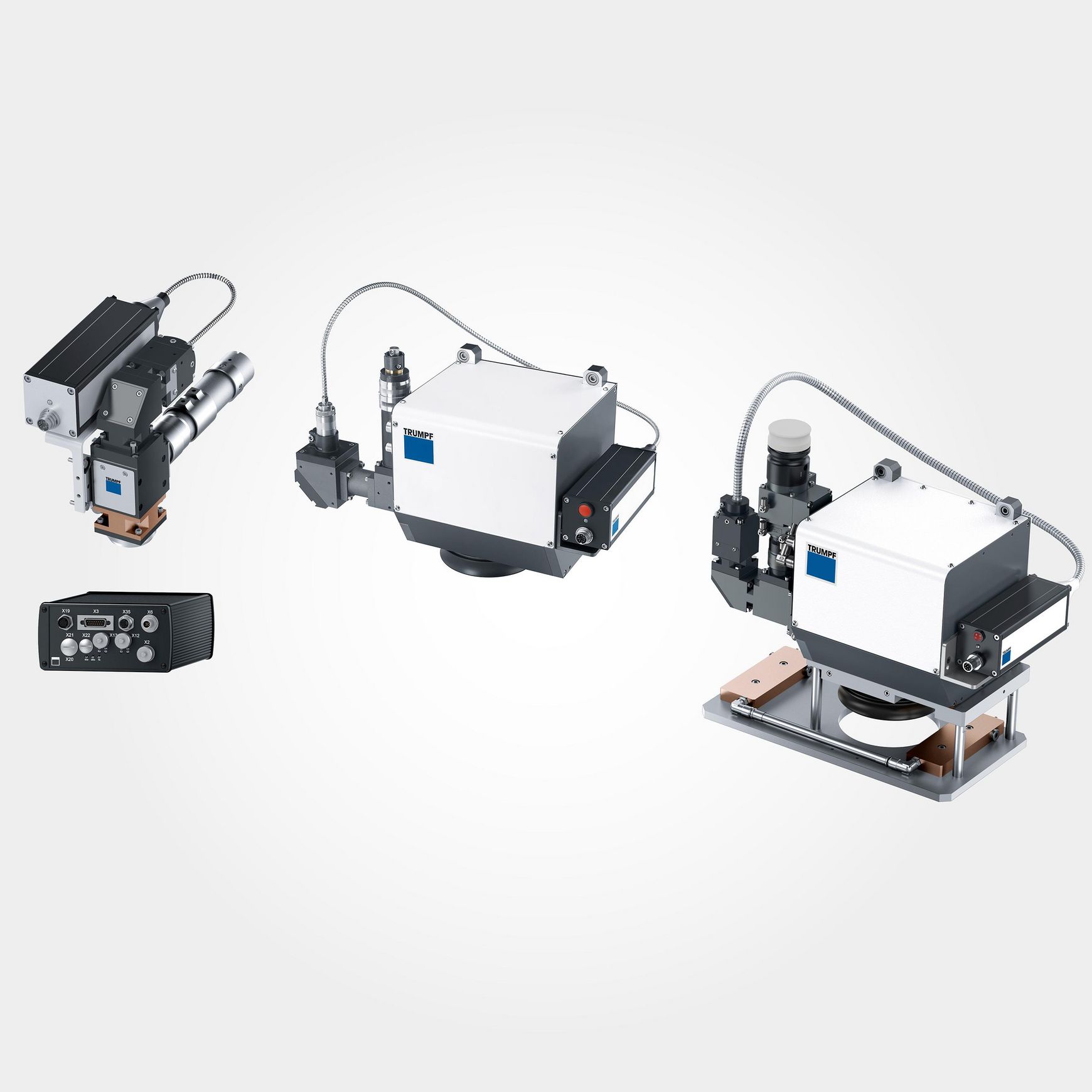

Pyrometer-based temperature measurement and control
Quality
Temperature control
Temperature measurement and control for laser welding and surface processing
  • Measures the surface temperature in real time and transmits the values to the control, which automatically adjusts the heat input
  • Ensures uniform melt formation along the welding contour during plastic welding
  • Enables consistent hardening and reproducible layer depths during surface hardening and overlay welding
