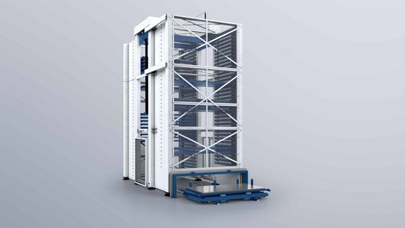

Single tower with variable height
With this storage tower with storage lift, you can choose from 13-16 height levels between 3.3 and 8.4 m. The tower stores up to 36 large format or 24 maximum format pallets.

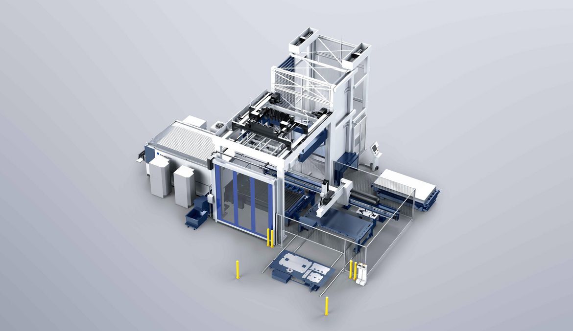

Processing cell with approx. 24 x 90 mm storage compartments: TruStore 3030 double tower storage system (approx. system height: 3.3 m), longitudinal storage input/output cart with lift, short side single cart for indirectly connected LiftMaster loading/unloading automation system with a TruLaser 3030 2D laser cutting system.

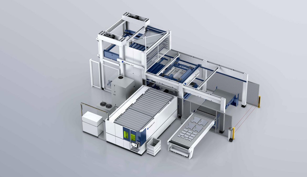

Processing cell with approx. 17 x 90 mm storage compartments: TruStore 3030 single-tower storage system (approx. system height: 5.5 m), storage input/output station under storage lift, directly connected LiftMaster Compact loading/unloading automation system on the long side and third pallet station with TruLaser 3030 2D laser cutting system.
Manufacturing solution for laser cutting with tower store
Processing cell with approx. 17 x 90 mm storage compartments: TruStore 3030 single-tower storage system (approx. system height: 5.5 m), storage input/output station under storage lift, directly connected LiftMaster Compact loading/unloading automation system on the long side with additional gantry station with PartMaster with TruLaser 3030 2D laser cutting system.
Processing cell with approx. 29 x 90 mm storage compartments: TruStore 3030 single-tower storage system (approx. system height: 7.8 m), short side storage input/output cart with lift, directly connected LiftMaster Compact loading/unloading automation system on the long side and PartMaster parts conveyor belt with a TruLaser 3030 2D laser cutting system.Reduced space consumption due to platform installation of beam source, compact dust extractor and process cooler.

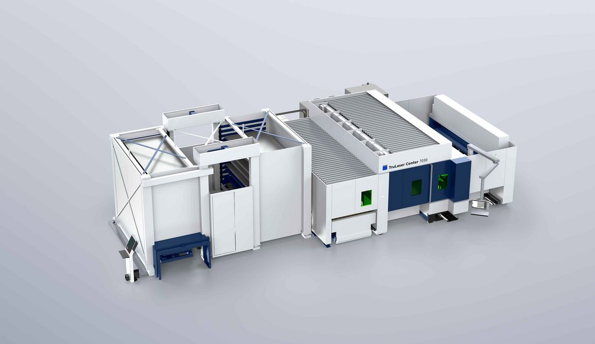

Processing cell with approx. 36 x 90 mm storage compartments: TruStore 3030 double tower storage system (approx. system height: 5.2 m) with short side storage input/output cart with lift and indirectly connected TruLaser Center 7030 full-service laser machine on the long side.

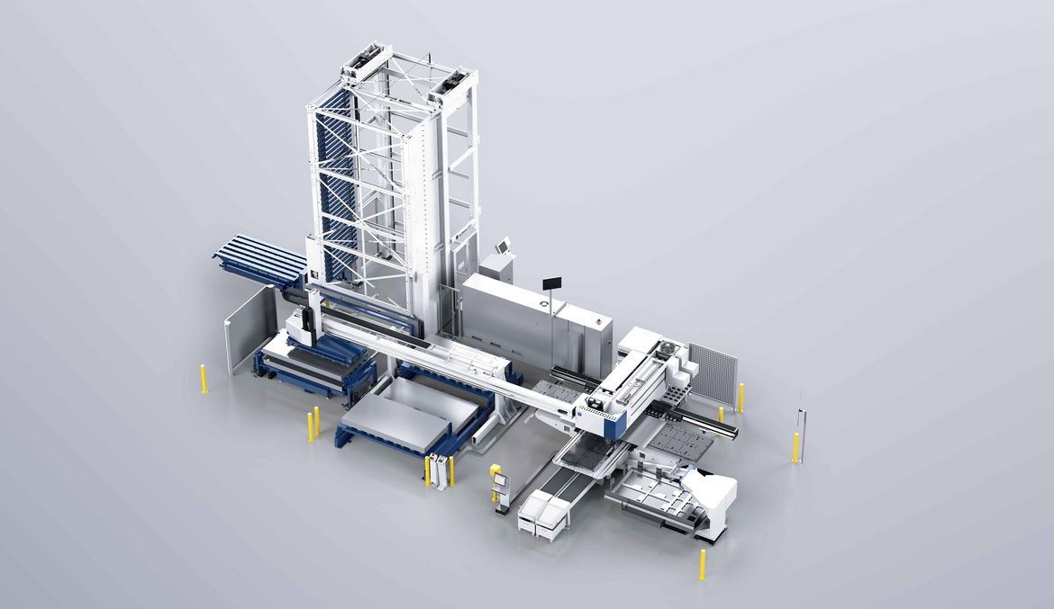

Production solution for punching / laser processing with tower store
Processing cell with approx. 32 x 90 mm storage compartments: TruStore 3030 single tower storage system (approx. system height: 7.8 m), short side storage input/output cart with lift, longitudinal dual cart indirectly connected to SheetMaster loading/unloading/sorting automation on a TruMatic 7000 punching/laser cutting machine.

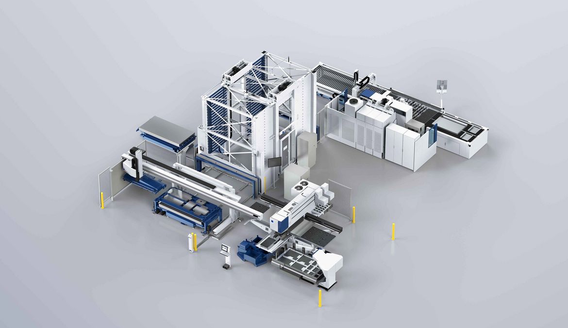

Processing cell with approx. 66 x 90 mm storage compartments: TruStore 3030 double tower storage system (approx. system height: 7.8 m), short side storage input/output cart with lift, longitudinal dual cart at the front and single cart at the rear with 2x indirectly connected SheetMaster loading/unloading/sorting automation on 2x TruMatic 7000 punch/laser cutting machines.
Manufacturing solution for punching and panel bending with tower store
Processing cell with approx. 42 x 90 mm storage compartments: TruStore 3030 double tower storage system (approx. system height: 5.5 m), short side storage input/output cart with lift, longitudinal dual cart on the short side and single cart at the rear with indirectly connected SheetMaster loading/unloading/sorting automation on a TruPunch 5000 punching machine and on a TruBend Center 7030 panel bender.
