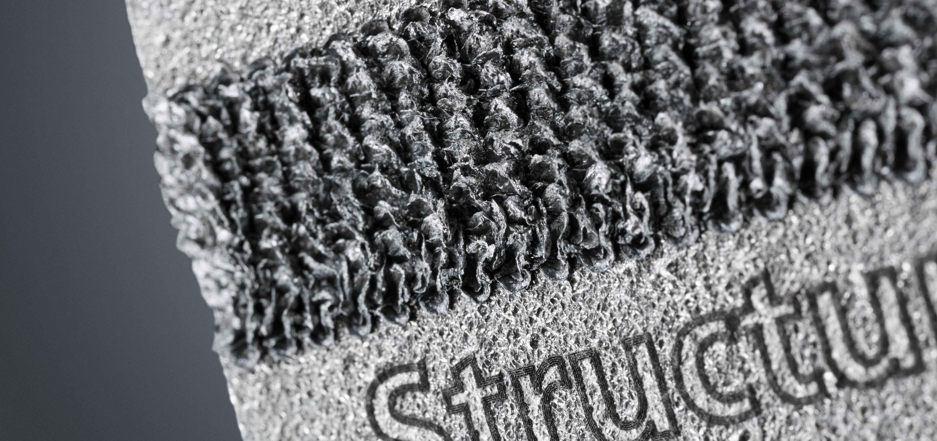

During structuring, the laser creates regularly arranged geometries in the layer or in the base material, so that the technical characteristics are changed in a targeted manner and a new functionality is developed. One example: scoring or applying small (oil) depressions for defined sliding properties. The individual elements in such structures often measure only a few micrometers. Short laser pulses with very high pulse power generate such high energy densities that the material usually evaporates immediately (sublimation). Each laser pulse produces a small depression, melt is predominately prevented.
Certain properties are generated by laser structuring which, for example, have an effect on the friction characteristics or electric and thermal conductivity. In addition, laser structuring increases the adhesive strength and longevity of the workpiece.

In laser structuring, regularly arranged geometries are generated in surfaces in a reproducible way using laser radiation (usually pulsed). The laser beam melts the material in a controlled manner and solidifies into a defined structure thanks to appropriate process management.
1. The laser radiation hits the workpiece surface.
2. The laser radiation heats the absorbing material.
3. Structures are generated as the melt solidifies.
