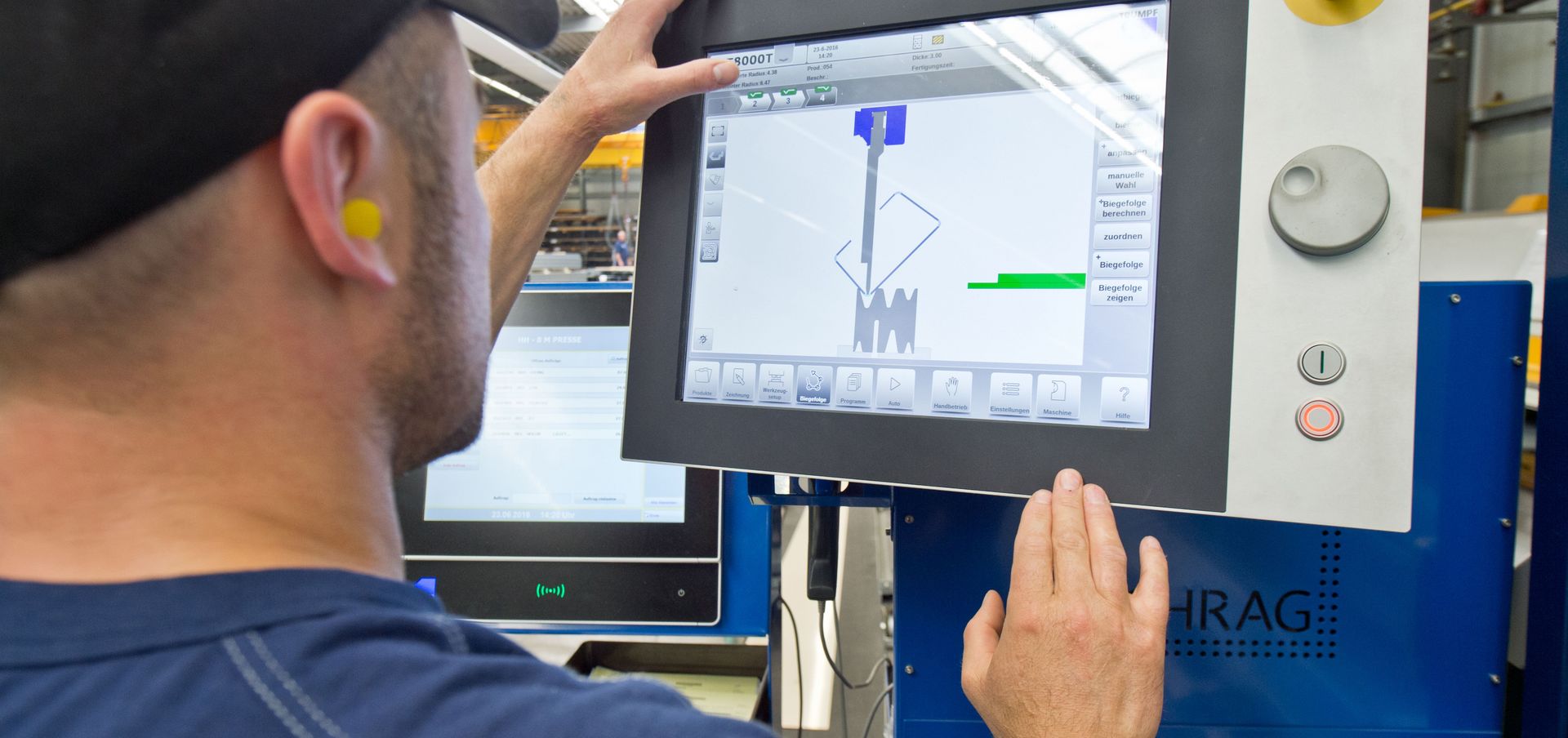

The machine’s control system has a high-resolution, 17-inch color flat panel display with built-in touchscreen. This enables users to load 2D and 3D programs as well as 3D simulations. “The new control system is a bit like using a smartphone or tablet, so it appeals to our young machine operators,” says Ingo Kleinau.

One new feature the press brake offers is the T8000T control system. With its high-resolution, 17-inch color flat panel display and built-in touchscreen, this system allows machine operators to load 2D and 3D programs as well as 3D simulations. “It’s a bit like using a smartphone or tablet, so it appeals to our young machine operators,” says Kleinau. The layout and operating concept are very different from the previous control system, however. “It didn’t take us long to get the hang of 2D programming. We’re still experimenting with 3D programming, but I think all the operators on all three shifts will be familiar with the controls in a few weeks’ time,” says Kleinau.

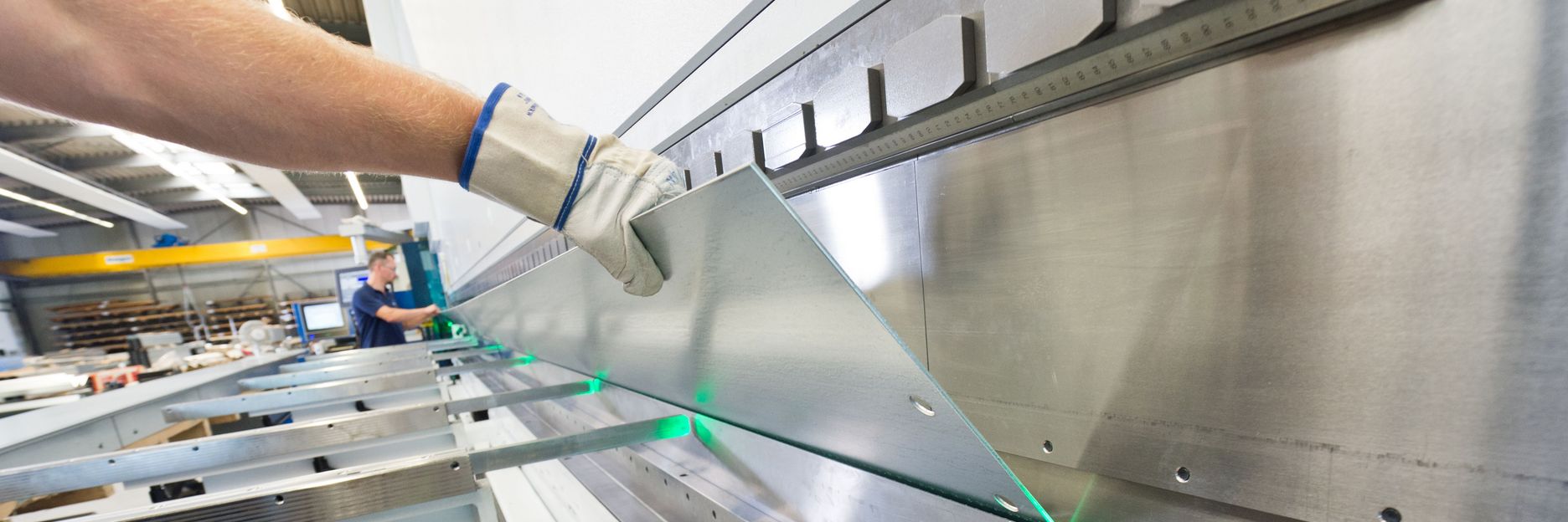

One highlight of the 400-ton press brake that everyone appreciates is the flexible tool system. “A key requirement for industrial buildings is that you don’t want water on the outer shell to drip onto a cut edge. Otherwise you get corrosion infiltrating the metal,” Kleinau explains. That’s why Schrag folds the edges over, which requires at least two different lower tool slots. They bend the sheet 45 degrees, fold it, bend it another 45 degrees and fold it again. And even then it still requires another 90-degree bend to produce a corner angle. “It simply wouldn’t work without lower tool displacement. That’s why it’s standard on all our machines,” says Kleinau.
