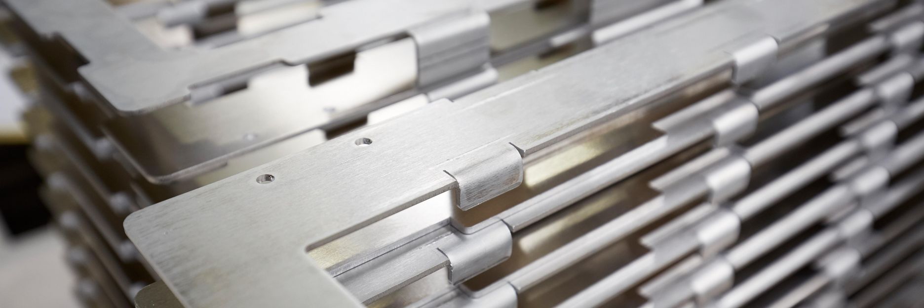

“Even after this short period in use we have been able to reduce by 40 percent the time needed to manufacture the front panel of a pay-and-display machine, made of aluminum and stainless steel. The separate working phase at the press brake for small bendings is eliminated because the new punch laser cutting machine already takes care of the necessary bends,” he tells us. Formed areas – like brackets, threads and hinges – are now made up quickly and easily on the TruMatic 6000 fiber. Four TRUMPF press brakes are used when processing larger parts and assemblies.

Formed areas – like brackets, threads and hinges – are now made up quickly and easily on the TruMatic 6000 fiber. (Picture: Claus Langer)

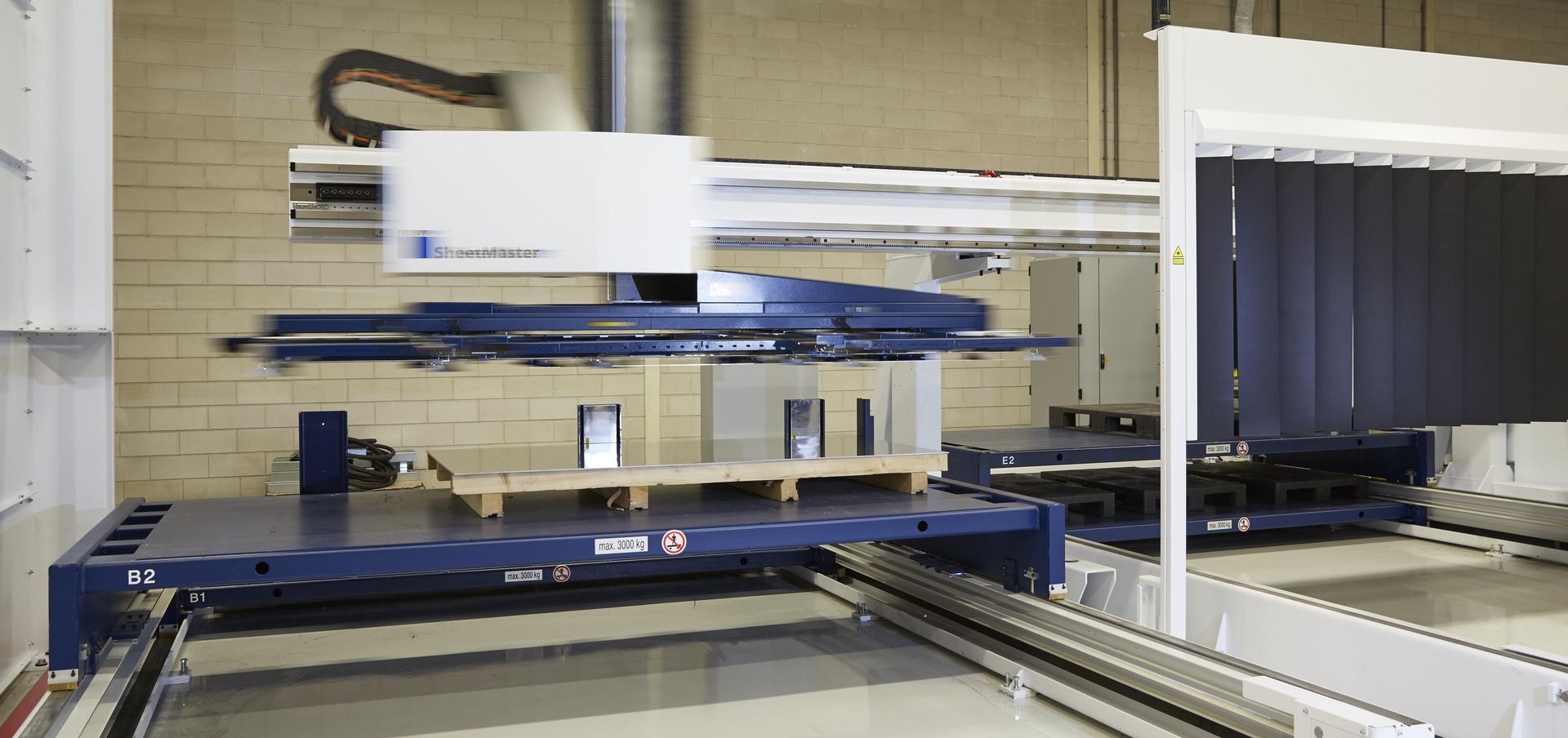

The SheetMaster is entrusted with loading and unloading the machine. It sorts the parts and lays them on the cart or pallet. (Picture: Claus Langer)

The SheetMaster is entrusted with loading and unloading the machine. It sorts the parts and lays them on the cart or pallet. Small parts are discharged through brush-equipped parts flaps, directly into pre-positioned boxes. The descending die also makes for movement of the material free of marring. There is no contact with the die while the sheets are being positioned on the machine. A laser presser foot with its own NC axis augments gentle handling, too.
