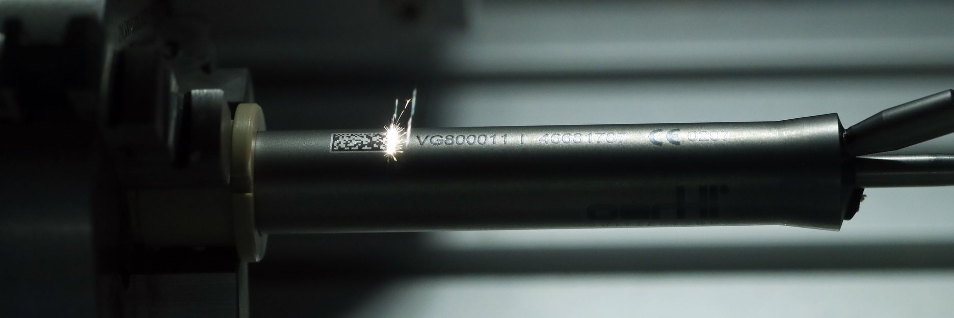

Black marking achieves good contrast on medical products
Andreas Conzelmann, CEO at TRUMPF Schweiz, sees the assignment by Oertli as an opportunity. After all, he explains, TRUMPF has to engage with regulations years in advance, and has gathered valuable expertise in doing so. The new UDI system was, however, a challenge for the approximately 100 engineers and physicists at the Grüsch competence center, he adds. "But having over 20 laser sources and three types of technology in our portfolio meant we are in a very good position to be able to react quickly," says Conzelmann.
UDI marking implemented using ultrashort pulse lasers
For the purposes of UDI, it was possible to use the ultrashort pulse laser (USP), which has been in use for years, and develop it further. "We already had the laser source which could produce a mark with utmost corrosion resistance in-house," says Conzelmann. The developers relied on black marking for the best possible contrast. In this process, a laser fires at the surface with extremely short pulses, creating structures within the nano range. The rough surface reduces the scattering of light, and the result is an extremely dark, high-contrast mark which can be easily read from various viewing angles, and is therefore considered "gaze-constant".
