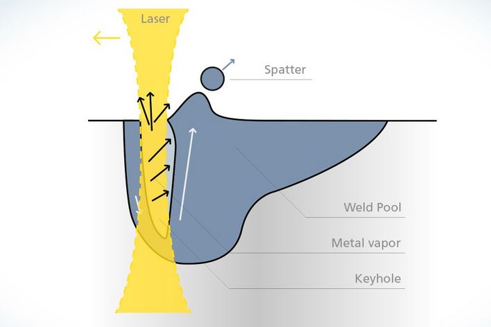

Why is spatter created during deep penetration welding?
TRUMPF laser welding without BrightLine Weld scheme
The laser beam heats the material up to evaporation. The emitted metal vapor sets the weld pool in motion and accelerates it - if the acceleration is too high, spatter comes off the keyhole rear wall.
This creates emissions in the weld seam and there is less material left to form the weld seam.
Effects on the weld result and the welding process
On the whole, not only is the quality of the seam impaired but additional precious time is also taken up: spatter can adhere to the component itself, the machine or the focusing optics, which then requires post-processing or cleaning. By implication, machine downtimes and more replacement procedures for the protective glass in optics create additional costs which are increased even more by a higher number of rejects due to insufficient weld seam quality.
