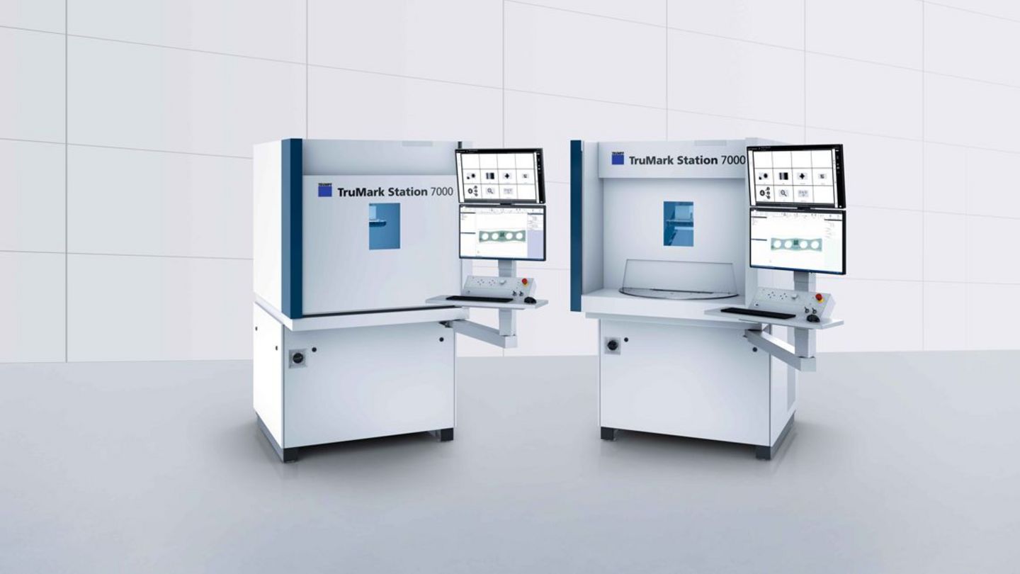

TruMark Station 7000 is suitable for high part quantities
TRUMPF will also showcase the TruMark Station 7000 at AMB. "With the largest workspace of all TRUMPF marking systems, users can use the system to mark individual, large components weighing up to 100 kg," says Breitenborn. The marking system is suitable for marking plastic washing-machine panels, for example. Dark, high-contrast scales or brand names are produced. These have no edges and are pleasant to the touch because the marking laser does not foam up the plastic.
As an alternative to a single large component, users can mark a particularly large number of small parts arranged next to each other. "The system is suitable for high volumes - especially if the system is equipped with our rotary changer," says Breitenborn. With the rotary changer system, users can load the TruMark Station 7000 with additional components while the laser is still working.
TruMark Station 7000+7000R
The TruMark Station is a laser marking system suitable for high part quantities. (Source: TRUMPF)
