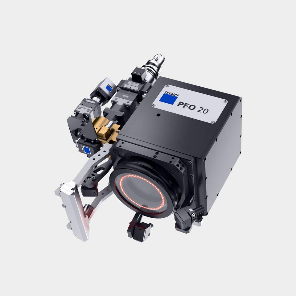

Programmable focusing optics PFO 20
PFO 20
Compact 2D scanner optics for welding and cleaning on small processing surfaces.
  • Cost-effective entry into remote welding and ideal for smaller components or rooms.
  • Most dynamic PFO thanks to particularly light mirrors and optimized galvo architecture.
Laser power: max. 6 kW
Processing field: 49 × 36 to 320 × 237 mm²

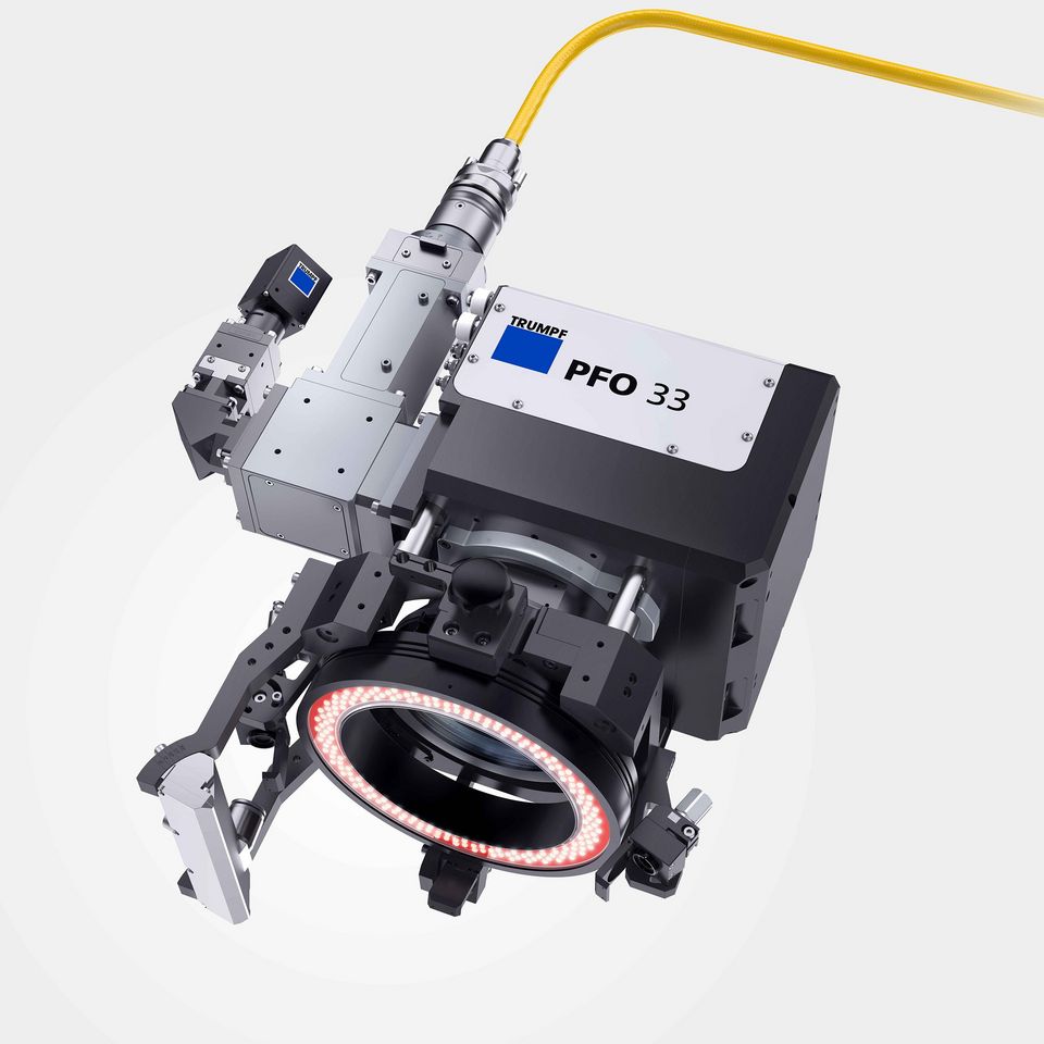

Programmierbare Fokussieroptik PFO 33 (KF023)
PFO 33 (12 kW)
High-performance 2D scanner optics for demanding requirements on large processing surfaces.
  • Proven industry standard: The most frequently used scanner optics for many applications.
  • Powerful: Ideal for deep weld seams and high removal rates.
  • Process-synchronized quality assurance: Enables reliable and precise welding depth monitoring thanks to OCT technology.
  • High speed thanks to lightweight mirrors and optimized galvo architecture.
Laser power: max. 12 kW
Processing field: 80 × 57 to 570 × 370 mm²
TRUMPF Focusing Optics PFO 33
PFO 33 (6 kW)
The PFO 33 is designed for laser processes where reproducible seam quality, stable energy input and high output are required – requirements typically encountered in battery and drive manufacturing.
Its optimized beam guidance, welding precision and temperature stability ensure consistent processes even in continuous operation.
  • Process-synchronized quality assurance: Enables reliable and precise weld seams.
  • Flexible PFO configuration: based on customer requirements. All TRUMPF components can be flexibly combined and adapted to your process.
  • Compact design: The minimal space requirements facilitates integration into machines and robot systems for greater mobility and faster cycle times.
Processing field: 162 x 110 to 320 x 208 mm²

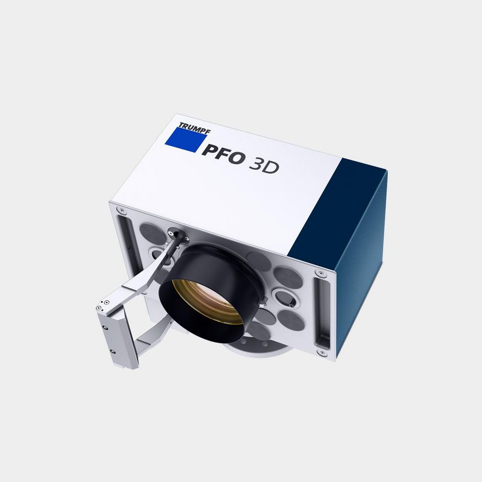

Programmable focusing optics PFO 3D
PFO 3D
Intelligent 3D scanner optics for laser welding and surface processing - delivering consistently high beam quality at varying working distances, ideal for complex welding jobs, flexible manufacturing, and quality control in the automotive industry.
  • Precise 3D processing: High dynamics and constant beam quality throughout the entire work area.
  • Flexible integration: Can be easily integrated into automated and robot-supported production lines with large components.
  • Intelligent process control: In combination with the TruTops I-PFO option, the optics take over complete coordination with the robot.
Dynamic Z-focus: Up to ± 260 mm

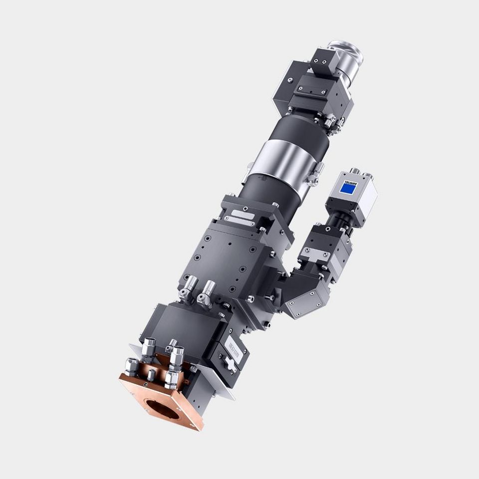

BEO D50 processing optics
BEO D50
Powerful mid-range for stable processes.
  • High process stability: An optional shielding gas nozzle ensures clean weld seams.
  • Robust design: The smart monitoring functions increase safety and process stability.
  • High tightness: The optionally available Multifocus element enables particularly stable and gas-tight weld seams.
  • Can be combined with our smart sensor systems: Also enables monitoring of the welding process with VisionLine OCT.
Laser power: max. 8 kW
also available as multifocal

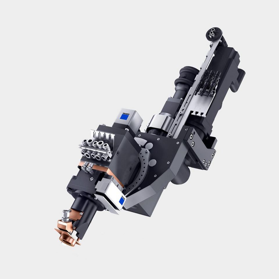

TRUMPF Fokussieroptik BEO D70 Schwenkoptik
BEO D70 swivel optics
Compact swivel optics for OEM applications - consisting of the BEO D70 focusing optics and an integrable swivel module.
  • Safe and stable: Smart monitoring functions ensure process stability and protect the laser from contamination and back-reflections.
  • Depending on the design of the focusing optics, the swivel optics can be used for 2D and 3D welding.
Can be combined with PMF: programmable motor-driven focus setting procedure (PMF)
