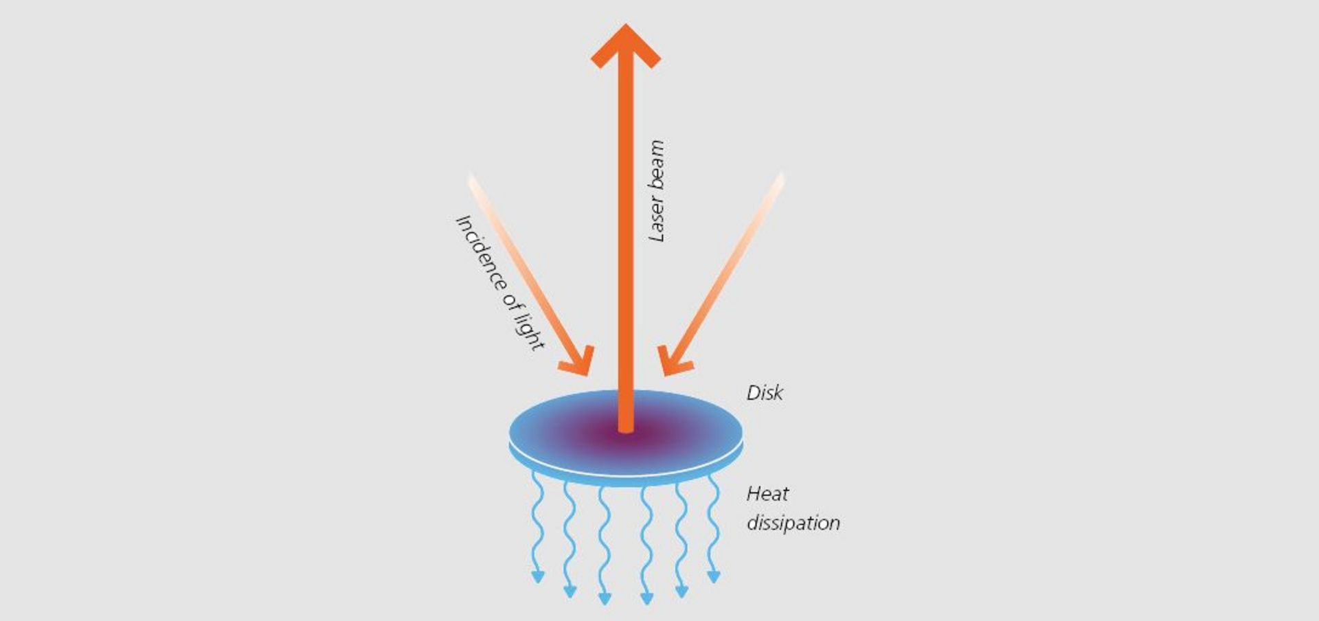

Could you briefly explain how it works?
Well at its core, as I said, is a Yb:YAG disk that is just about a few hundred micrometers thick—the surface area to volume ratio solves the cooling problem. What’s more, the direction of the temperature gradients is almost exclusively axial, which results in minimal thermal lens effects. The laser medium is pumped in a multipass configuration that consists of a parabolic mirror and a deflection system. It actually sounds relatively simple, but the technology is highly complex. The pump beam is refocused by a mirror into the laser crystal.
The highly reflective coating on the back of the disk reflects back any non-absorbed radiation. Repeat that enough times and you get highly efficient absorption of the pump light, and the pump source doesn’t even have to be particularly brilliant for the disk laser to exhibit good beam quality.
