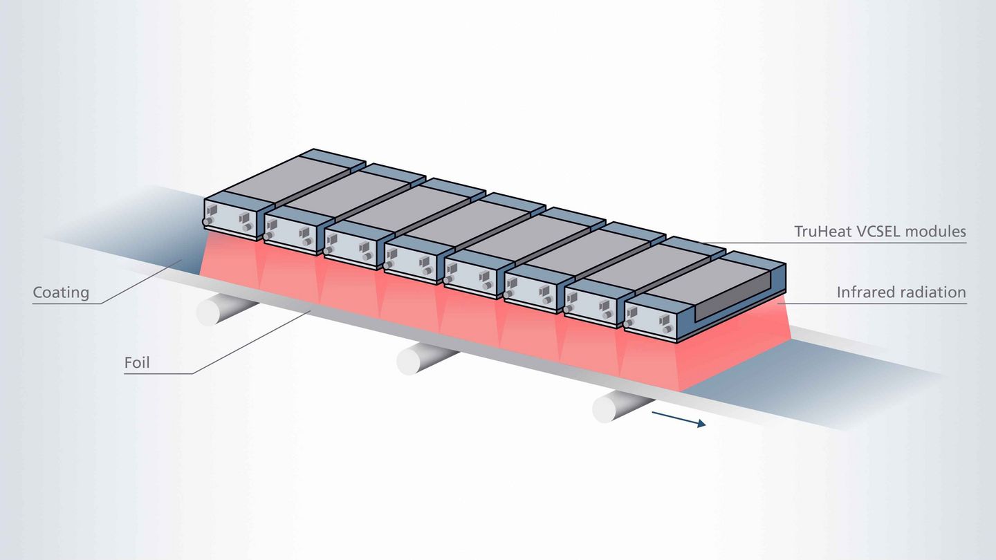

The TruHeat VCSEL laser heating systems have a modular design with separate zones. This enables the precise control of individual illumination zones to support not only optimal homogeneity but also the customization of intensity profiles, for example, a lower or higher intensity at the edges of the coating. Another unique property of the TruHeat VCSEL modules is their compactness and the low working distance. This enables easy integration, even in existing lines.

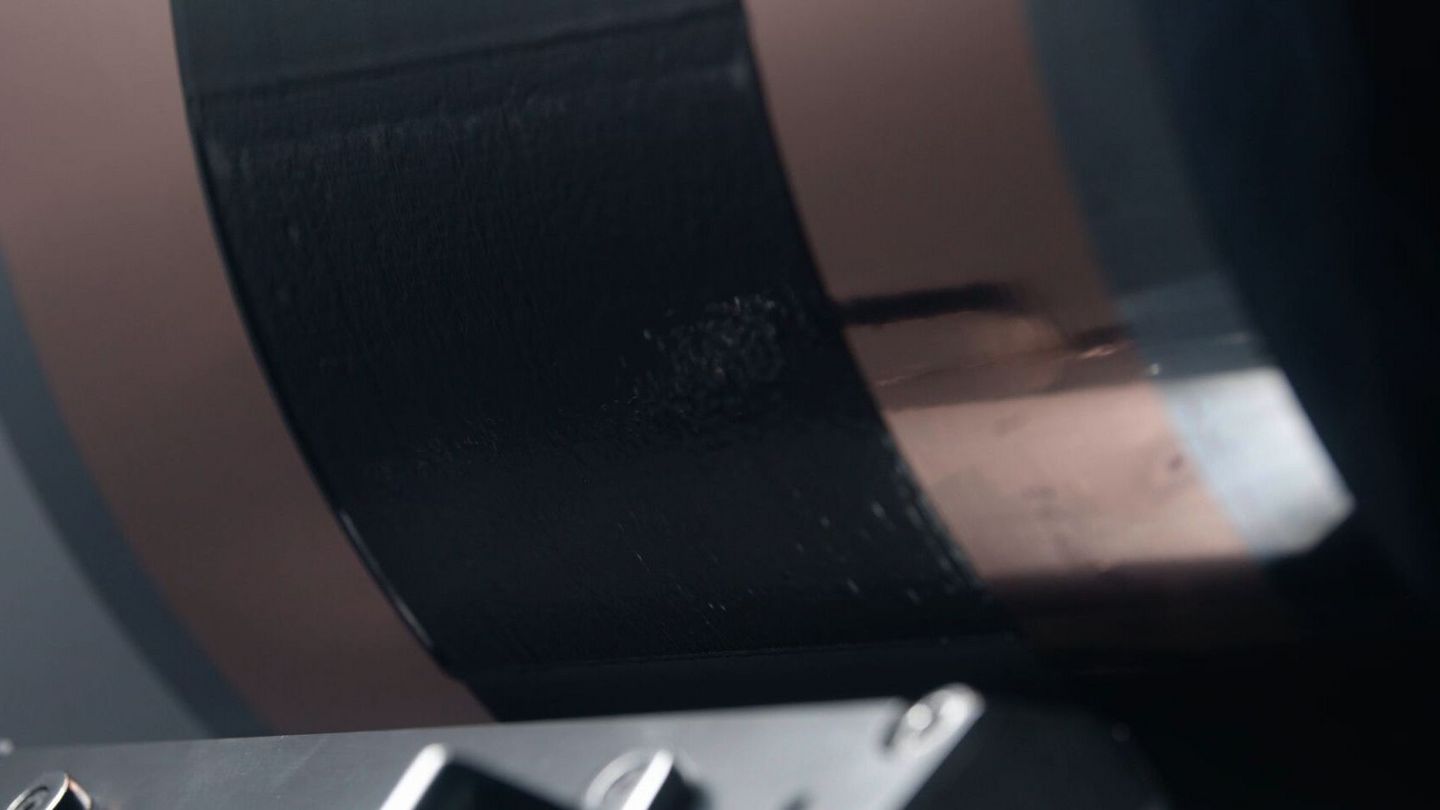

Picture 1
TruHeat VCSEL heating solutions from TRUMPF for Li-battery manufacturing enable more efficient production in a variety of process steps. © TRUMPF
Picture 2
The next-generation Vertical-Cavity Surface Emitting Laser (VCSEL) TruHeat 5010 is a low-power-density infrared laser source designed for the drying of battery electrodes. © TRUMPF

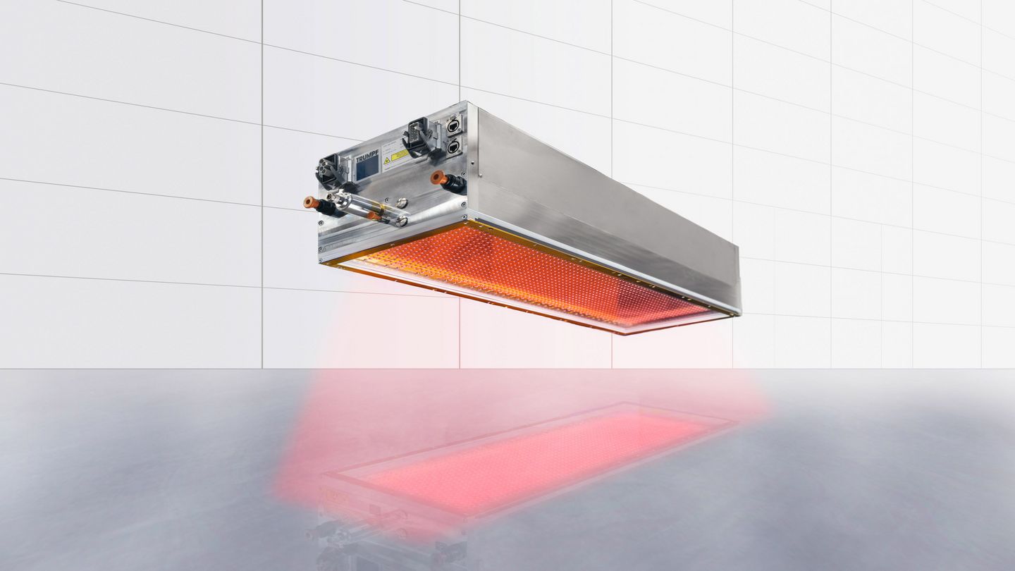

Picture 3
At the process step for battery foil drying, VCSEL heating systems efficiently dry the active material on the electrode with nearly no energy loss, thanks to their direct heat treatment. © TRUMPF
