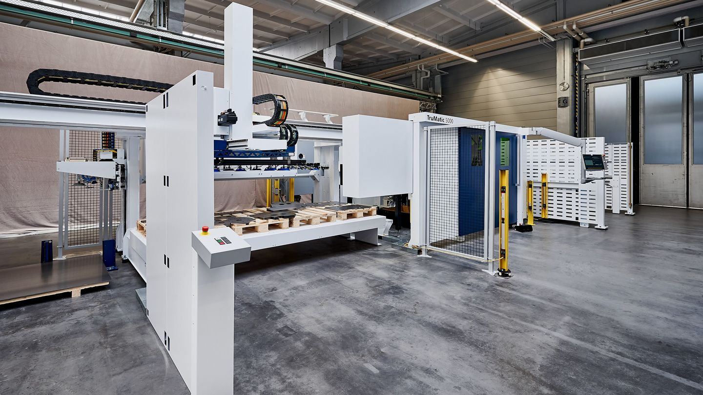

Ditzingen, Germany, October 17, 2023 – TRUMPF is poised to launch its TruMatic 5000 manufacturing cell with the new SheetMaster at Blechexpo in Stuttgart. Users of the new system will benefit from fully automated laser-cutting, punching and forming capabilities. The new SheetMaster enables a fully automated flow of materials within the manufacturing cell – from loading and unloading the machine to removing finished parts. “The TruMatic 5000 is yet another example of TRUMPF’s market-leading position in the field of connected manufacturing. This solution is designed to be seamlessly integrated in a self-contained smart factory, giving users efficiency gains along the entire process chain,” says TRUMPF product manager Steffen Wagner. TRUMPF’s new machine is equipped with a six-kilowatt fiber laser to maximize productivity. As well as saving energy, this laser also does an impressively fast job of cutting sheet-metal parts. The system comes with a descending die that prevents parts from being scratched during the punching process. The TruMatic 5000 punching head also comes with a patented TRUMPF electric drive known as the DeltaDrive, which uses around 30 percent less energy.

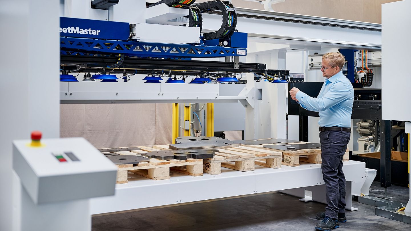

SheetMaster enables fully automated material flow
TRUMPF has fully automated the material flow in the TruMatic 5000. This improvement was made possible by the new SheetMaster technology, which uses grippers to handle parts in the manufacturing cell. The suction cups on the new SheetMaster’s grippers are monitored by sensors and can be activated individually. This makes gripper operation even more flexible, speeding up workpiece handling and saving valuable time, especially for smaller batches. In addition, the SheetMaster can be connected to an automated STOPA storage system which automatically supplies the manufacturing cell with raw material. The system also palletizes and sorts parts without human intervention. Further benefits of the new SheetMaster include its ability to eject cut and punched parts from the manufacturing cell. Parts can then be transported directly to the next stage of the process, such as bending, deburring or grinding. This reduces non-productive time and increases efficiency on the shop floor.

SheetMaster
The new SheetMaster enables fully automated material flow within the TruMatic 5000 manufacturing cell – from loading and unloading the machine to removing finished parts. (Source: TRUMPF)
TruMatic 5000
The new TruMatic 5000 provides a fully automated system for laser cutting, punching and forming. (Source: TRUMPF)

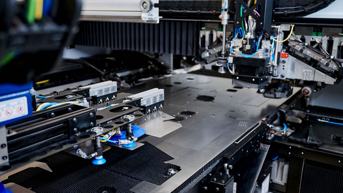

More flexibility
The suction cups on the new SheetMaster’s grippers are monitored by sensors and can be activated individually. This gives the grippers greater flexibility and speeds up part handling.
