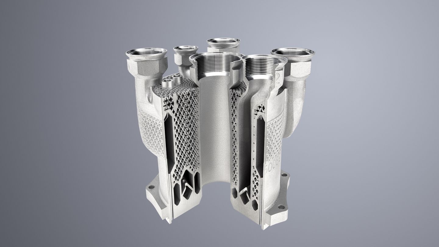

Einspritzdüsenring der Blasius GERG GmbH
New titanium alloy
The aerospace, energy and automotive industries are benefiting from the new titanium 6242 material. The picture shows an injection nozzle ring from Blasius GERG GmbH. (Photo: TRUMPF)
