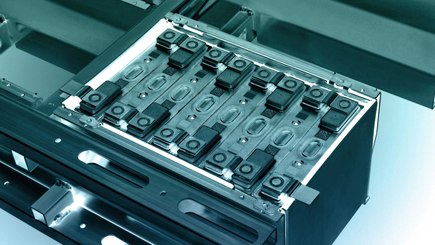

Quality control of batteries with AI
Users reduce their production costs with the AI solution from TRUMPF, as the AI solution can replace other, time consuming quality inspections.
