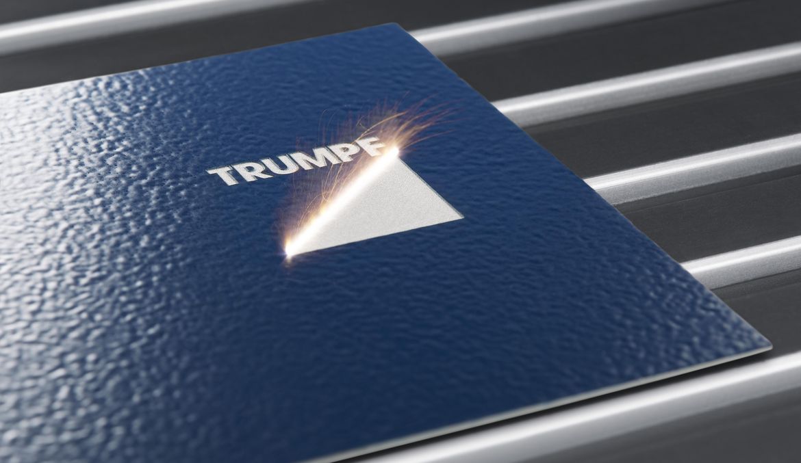

Ablation of paint layers
With the TruMark 6030 you can easily ablate layers of paint. With short, powerful laser pulses, the irradiance becomes so high that it causes the top layer to melt and evaporate or break down.
