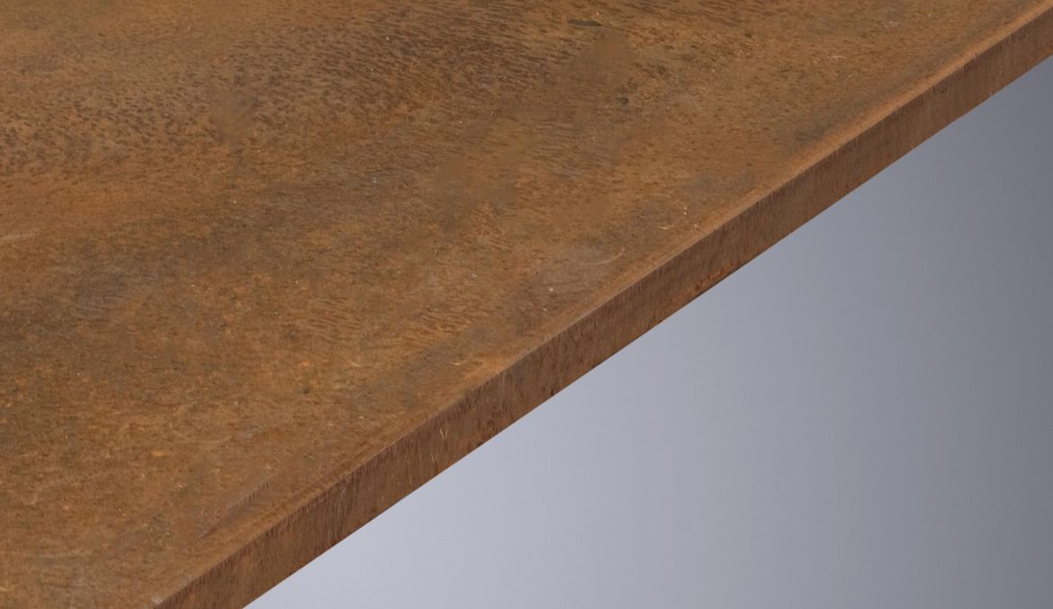

The TruTool TKF 1500 is equipped with a powerful 2,600 W motor.Hand protection, integrated on the motor, ensures a high degree of user-friendliness and safe operation. The soft grip ensures user-friendly operation with low vibrations. This means you can always expect consistent, oxide-free results. Regardless of whether you are processing straight sheets, T-beams, or tubes. The surface roughness remains low.

For straight edges and radius edges
Weld seam preparation on outer and inner contours. With interior cutout diameters from 5 inches. Also for T-beams and double T-beams.

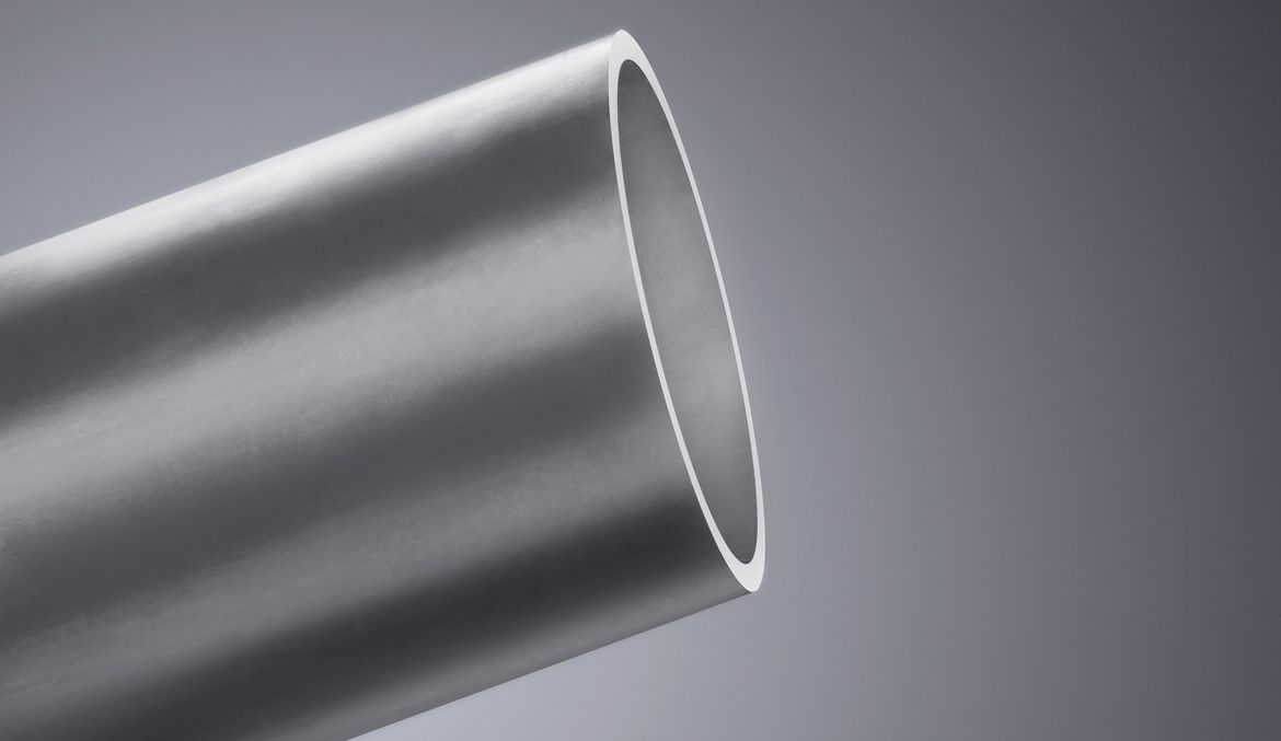

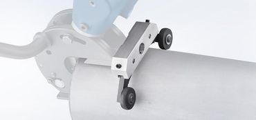

Tubes
Weld seam preparation on tubes with an inside diameter from 1.2 inches.

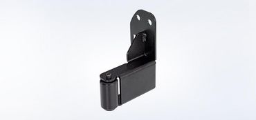

Roller holder complete, right
1 unit 1238982

Roller holder tube processing
For tube external machining Ø 3.5 - 7.8 in. with stripper

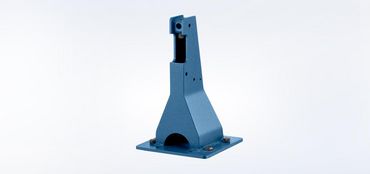

Work station with pedestal
Ideal for processing small parts in stationary use. For TruTool TKF 2000, order the adapter 1653155 separately.
1 unit  0005079

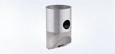

55° special-purpose stripper
For an angle of bevel between 20° and 55°
1 unit  0032119

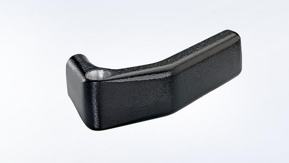

Handle
Enables fatigue-free work with maximum movement
1 unit  0023210
