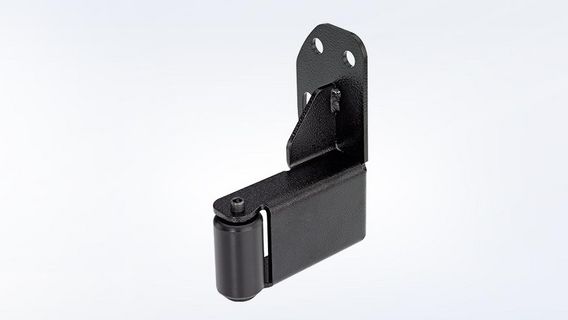

Roller holder complete, right
1 unit 1238982

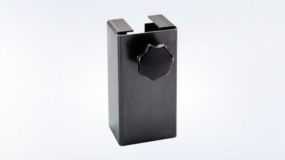

Stripper
For an angle of bevel between 20° and 45°. For special part no. 0027798 for tube processing.
1 unit  0023242

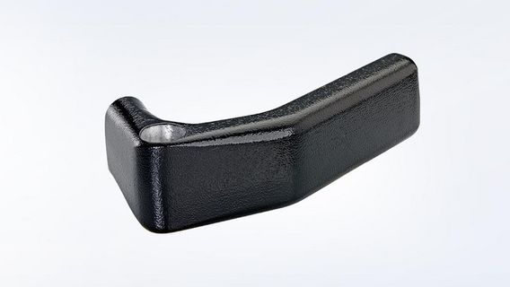

Handle
Enables fatigue-free work with maximum movement
1 unit  0023210

Roller holder tube processing
For tube external machining Ø 3.5 - 7.8 in. with stripper
1 unit  0005123
