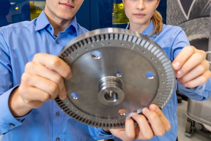

Laser-safe windows can usually be identified by their green color. In addition to a CE marking, a laser-safe window comes with further information, for example, on the protection level.
