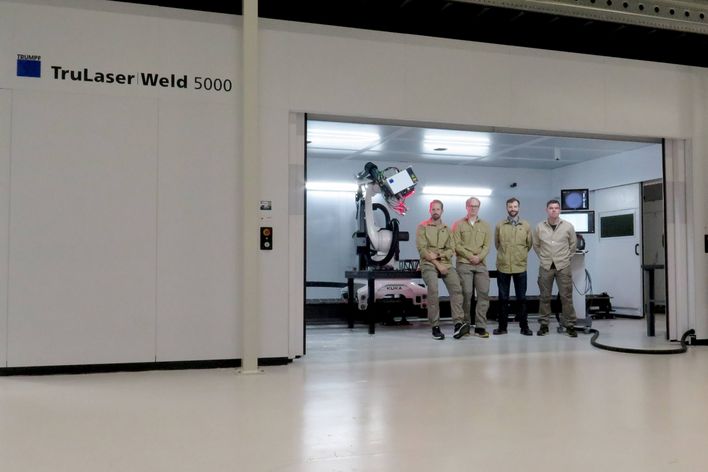

Gestamp has teamed up with TRUMPF to develop an industrial-grade laser welding process for fast and flexible welding of large-format, coated structural parts.

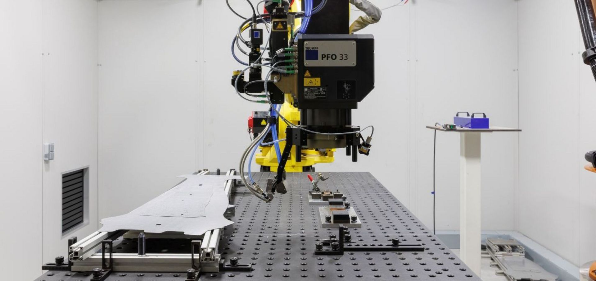

The challenge in laser welding coated components is that the two different materials do not bond homogeneously. During the melting process, intermetallic phases and alpha ferrite form, which are structural components that negatively affect the seam quality and the resulting structural mechanical properties of the component. “The key to the solution lies in laser beam shaping – in Gestamp's case, in the multifocus optics option,” explains Marc Hummel, Global Business Development Manager Mobility at TRUMPF. With the multifocus option, the laser beam is split into four individual beams, each with the same energy input. Each beam has a core beam and a ring beam. The latter “calms” the melt pool with its additional energy and prevents spatter formation. The four individual beams mix the AlSi coating in a controlled and homogeneous manner in the melt pool, thus preventing the formation of intermetallic phases and alpha ferrite. The result: a stable seam with high strength and tensile hardness. “You can compare it to stirring dough,” says Hummel. “The more stirrers mix the dough, the better it is at breaking up any lumps.” ​​​​​​​
With the multifocus option, the laser beam is split into four individual beams, each with the same energy input. This allows the AlSi coating to be mixed in a controlled manner in the molten pool, resulting in a stable seam with high strength and tensile hardness.

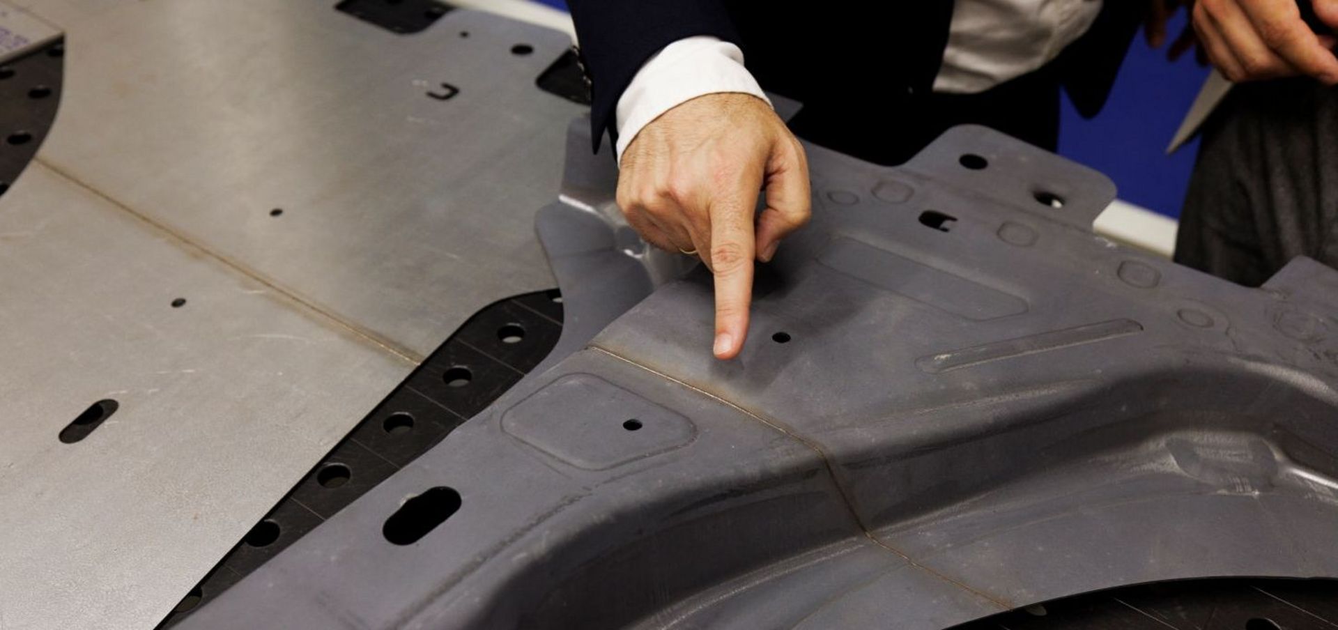

One advantage of the laser is that it welds on one side only. This has the advantage of what is known as a “semi-visible surface.” The seam is barely visible.
Thanks to TRUMPF beam shaping, significantly higher speeds and better seam quality can be achieved during welding. In addition – which is important for large structural parts – the laser offers better accessibility without reducing the process speed.
