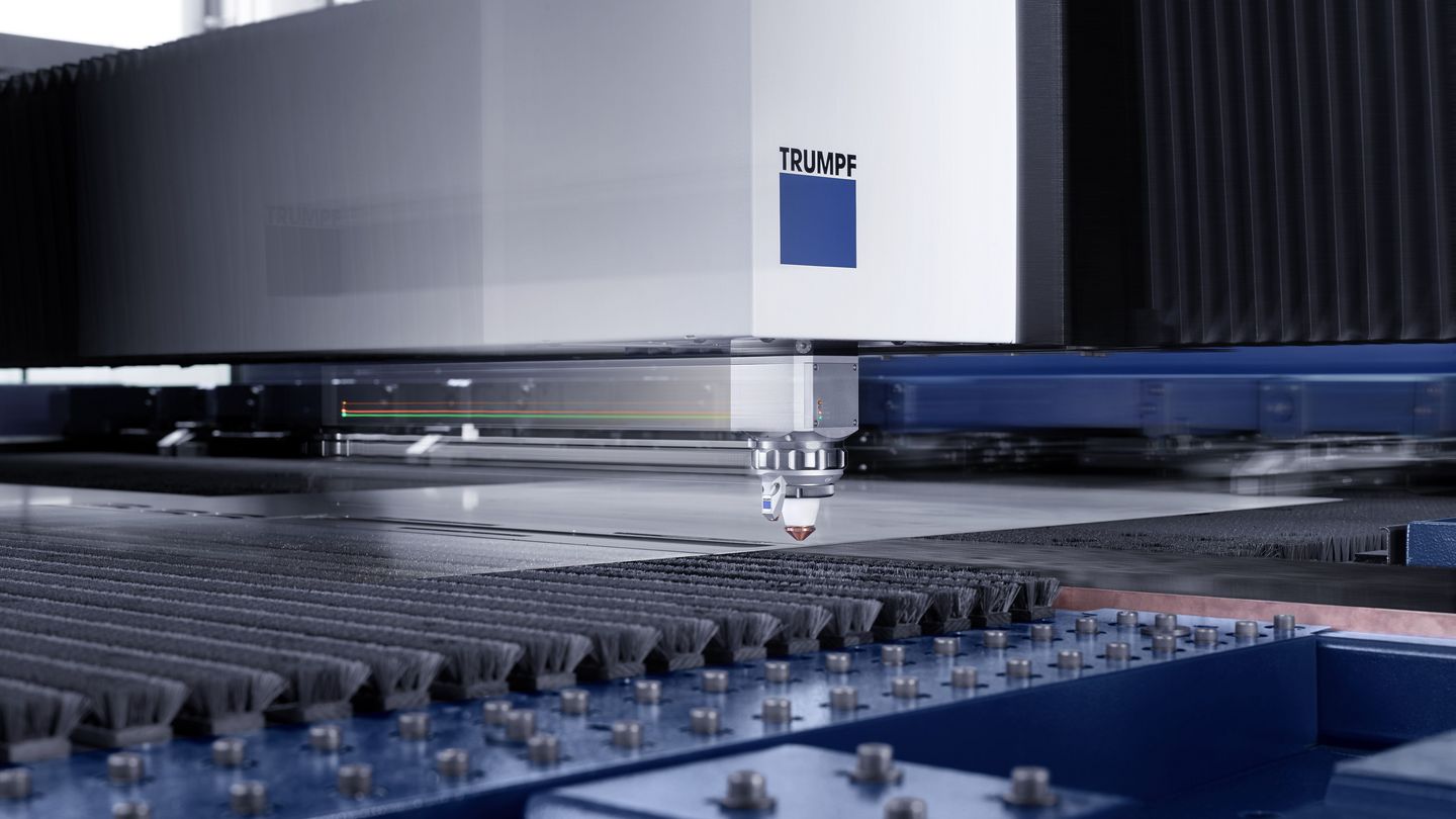

High dynamics through additional axis of the optic
The TruLaser Center 7030 works with a TruDisk solid-state laser, with six kilowatts of laser power. In terms of cutting productivity, it is easily on a par with today's high-end machines with flying optics, even though the sheet, with its relatively high mass, is moved precisely over the brush table in the Y direction. This was made possible by two solutions. Firstly, the sheet – maximum large format 3000 mm by 1500 mm – is moved across the short side. And secondly, the cutting optic, which moves mainly in the X direction, has an additional axis in the Y direction with travel of ± 55 mm. This means that with smaller contours, only small masses need to be accelerated, enabling high dynamics.

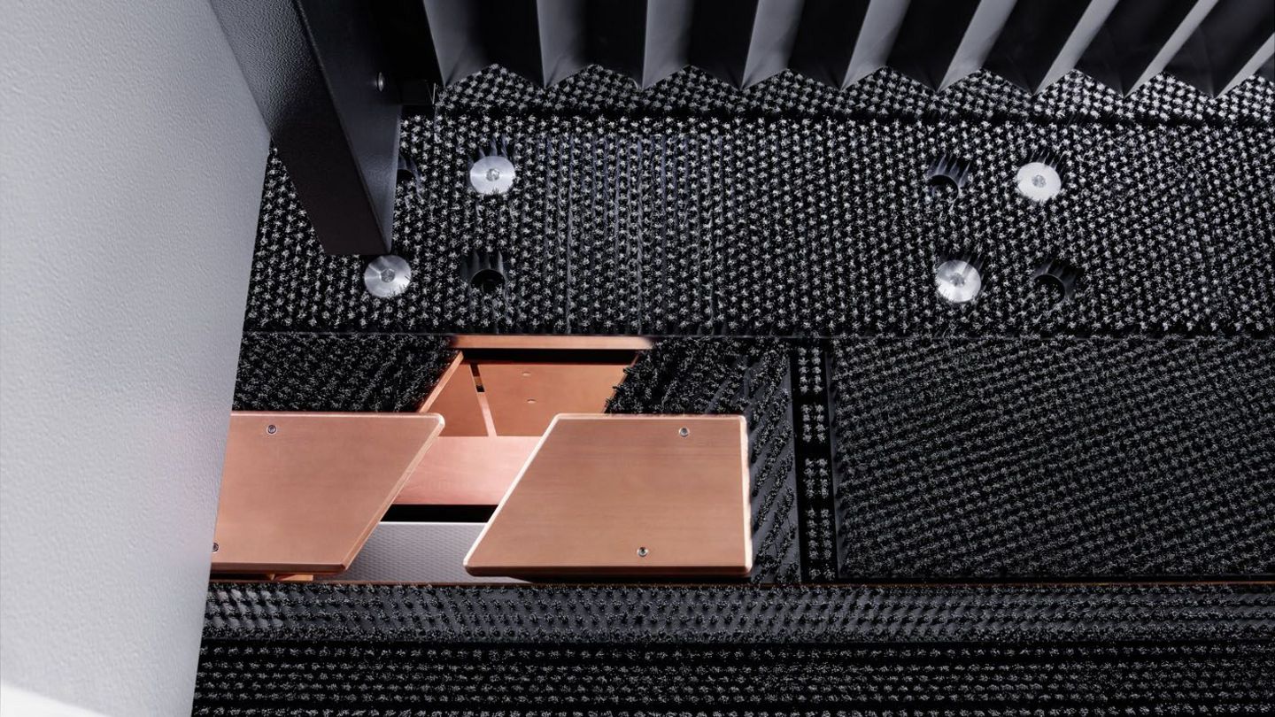

Secure part support thanks to the mobile “SmartGate”
On a hybrid machine, the support table for the sheet has to be divided beneath the path taken by the cutting head. This creates a gap through which the laser beam can escape downwards, but through which slag, slugs and cutting gas are also extracted. To prevent any sheet contours from getting caught there and to enable a far more efficient exhaust system, the TRUMPF developers invented the SmartGate: two slides which move synchronously with the cutting head. They can also change their distance from each other, to create different-sized gaps. This results in two major benefits: The sheet is securely supported during the cutting process, and small parts measuring up to 160 mm by 160 mm can be simultaneously ejected downward.

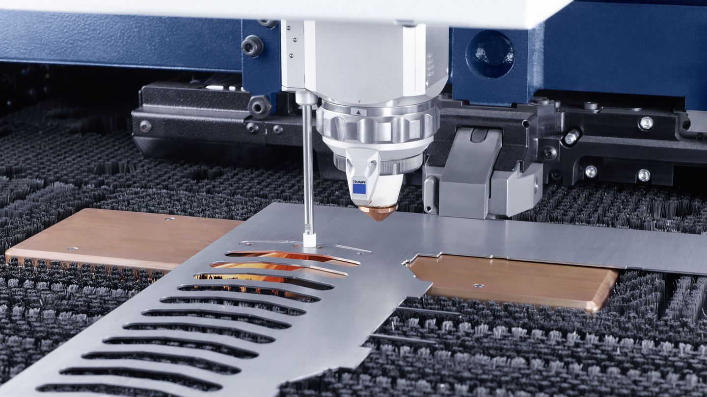

To ensure maximum process reliability, an ejector cylinder has been attached to the cutting head that presses the sheet metal parts outward and downward. The programming system TruTops Boost calculates the ideal pressing-out point automatically to suit the respective part contour. Since the slides below form a counter-bearing parallel to the sheet, the workpieces cannot tilt over. Scrap and slag fall directly into the scrap cart, or are transported out of the machine on a conveyor belt. Good parts are intercepted by a retractable sorting flap, and the SortMaster Box Linear distributes them into a maximum of eight containers.

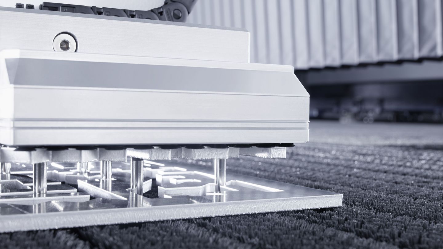

Process-safe removal of parts from the scrap skeleton
For the automatic removal of the remaining parts from the scrap skeleton, the TRUMPF experts developed SmartLift and SortMaster Speed – and this represents an intelligent, completely new and, above all, process-safe solution. With one stroke on the SmartLift, the cut parts are lifted off the scrap skeleton from below via a total of 180 freely positionable pins. Each individual pin can lift a weight of up to ten kilograms, making the process far more powerful than today's suction solutions. At the same time, the SortMaster Speed pushes down from above with its suction plates, ensuring precise linear guidance during lifting. As a result, any risk of parts tilting over into the kerf can be safely ruled out. The two telescopic arms on the SortMaster Speed are equipped with three suction plates each, and can sort and stack parts onto a maximum of eight Euro pallets across a total area of 1.6 by 4.8 meters.
Only minimal cutting interruptions
TruTops Boost also calculates the optimal position of the pins and suction plates automatically – enabling removal of very large parts as well as smaller ones no larger than a credit card. Even highly complex or very filigree geometries – considered impossible to remove mechanically until now – are lifted safely from the sheet, without the need for any additional programming. The strategies for removing and cutting the parts are coordinated in such a way that the machine continues to cut even while the parts are being transported away.

Smart Gate
The SmartGate: Two slides move synchronously with the cutting head, and the distance between them changes automatically. As a result, parts rest securely on top, and smaller parts can be directly ejected.
Cutting Head
Increased process safety due to a pressing-out cylinder: The TruTops Boost programming software calculates the ideal pressing-out point automatically.
SmartLift Pins
Safe removal: With the SmartLift, the freely positionable pins push the cut parts upward from the sheet skeleton, while the SortMaster Speed, with its suction plates, presses down on them from above.
Cutting Action
With its cutting productivity, the TruLaser Center 7030 is easily on a par with any classic high-end machine using flying optics.

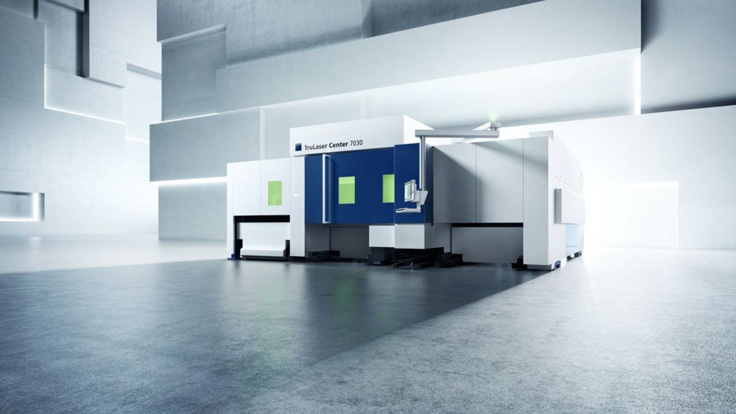

The TruLaser Center 7030 is capable of working autonomously over long periods, without the need for any operator intervention.
