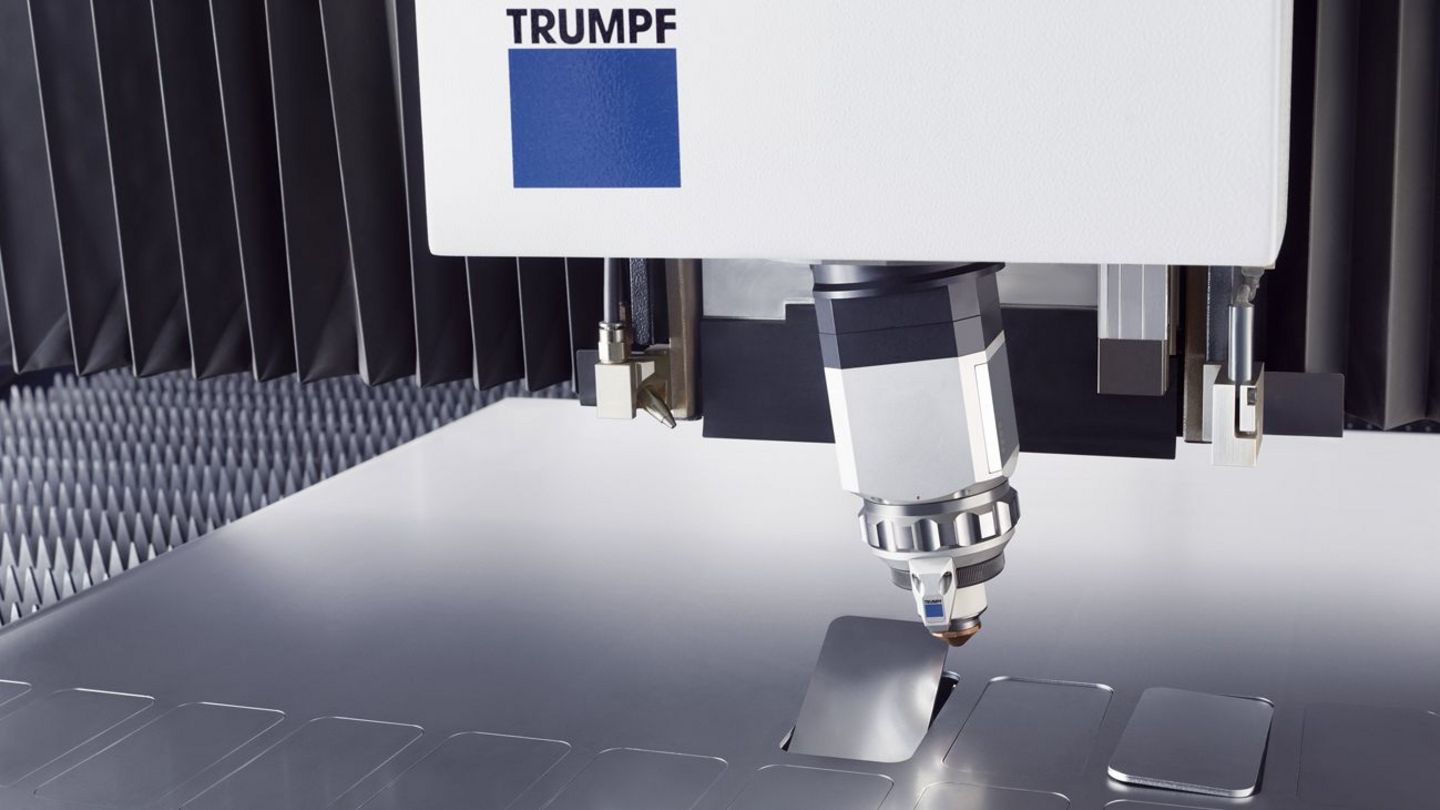

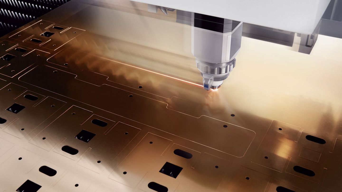

The new series consists of two types of machine, the TruLaser 1030 fiber and the TruLaser 1040 fiber with work areas three and four meters long, respectively. The TruDisk solid-state laser operates at constant power and is insensitive to reflections off copper, brass and other materials that reflect when cut. TRUMPF ships these machines out with data for cutting many commonplace materials and thicknesses of sheet metal. It enhances their process reliability - they can even cut copper with nitrogen. Machines with a four-kilowatt laser are equipped with BrightLine fiber. With this function, they can cut thick mild steel in a process-reliable way. In the event of a collision with tilted parts, a special protective mechanism deflects the cutting head to prevent damage to the cutting head and the machine. The TruLaser Series 1000 deposits slag and small parts in five pull-out drawers below the machine's frame.

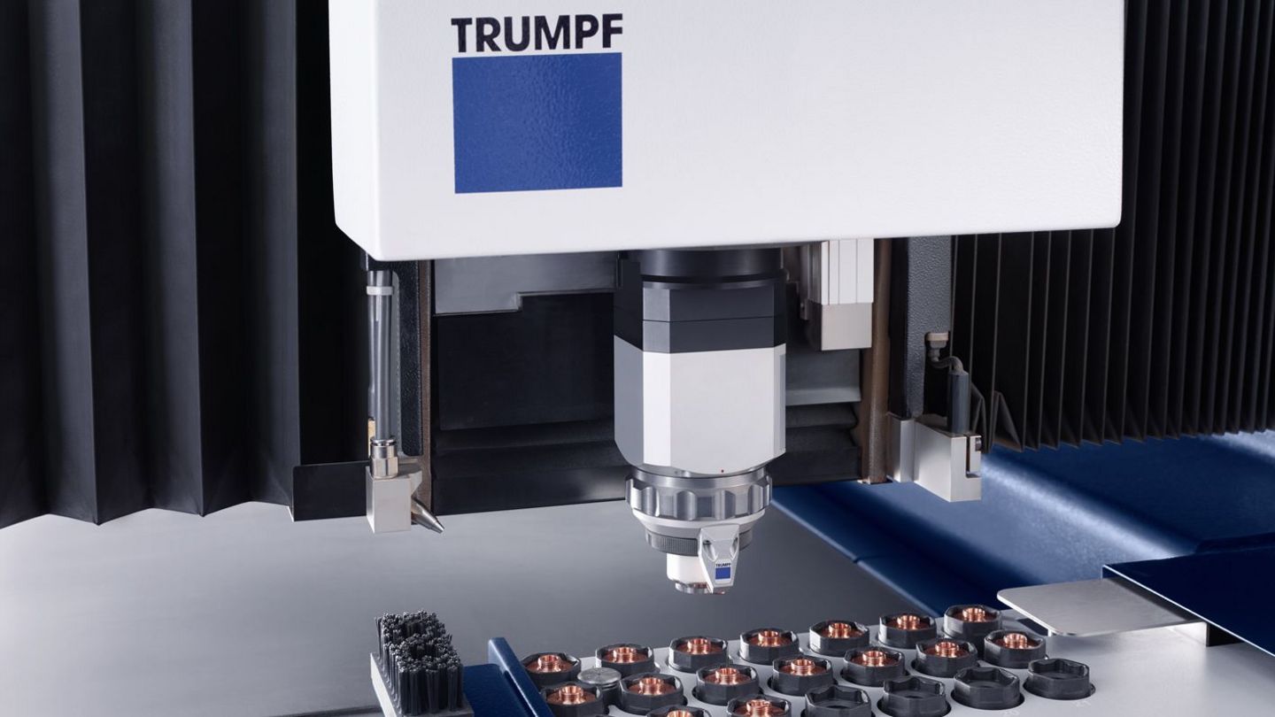

This re-engineered line of TRUMPF machines is far more dynamic than its predecessor. Positioning speed is up from 85 to 140 meters per minute. This speed is down to the design of the machine's body, which combines a rigid machine frame with a lightweight motion unit and powerful drives. The machine cuts all materials and sheet thicknesses with the same cutting head. It changes nozzles automatically thanks to the optional nozzle changer. Sensors monitor the optics' protective glass and let the operator know when it is time for a replacement. Visual inspections are a thing of the past. All this reduces the machine's setup time. The TruLaser Series 1000 also saves time during the cutting process. The PierceLine feature reduces piercing time by up to 80 percent and protects the machine and material. These machines operate very energy-efficiently with an average power consumption of 13 kilowatts for the 3-kilowatt laser and 14 kilowatts for the 4-kilowatt laser. They also come with more energy-conserving features, as do their periphery modules.

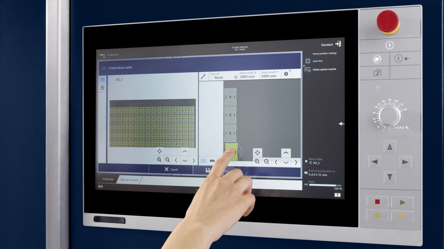

The TruLaser Series 1000 features a new 18.5-inch multi-touch control panel. It displays the most frequently used menu items at the top level. If the operator interrupts an operation, the control unit enables processing to resume at the same point. The monitoring capability is not limited to the protective glass: Other sensors track the condition of components that impact the machine's cutting performance. A traffic-light readout on the control panel called 'the Condition Guide' indicates the status. It also offers guidance when the operator needs to take action. Flow charts make it easier to forecast actionable events and provides a more efficient way of scheduling maintenance work.

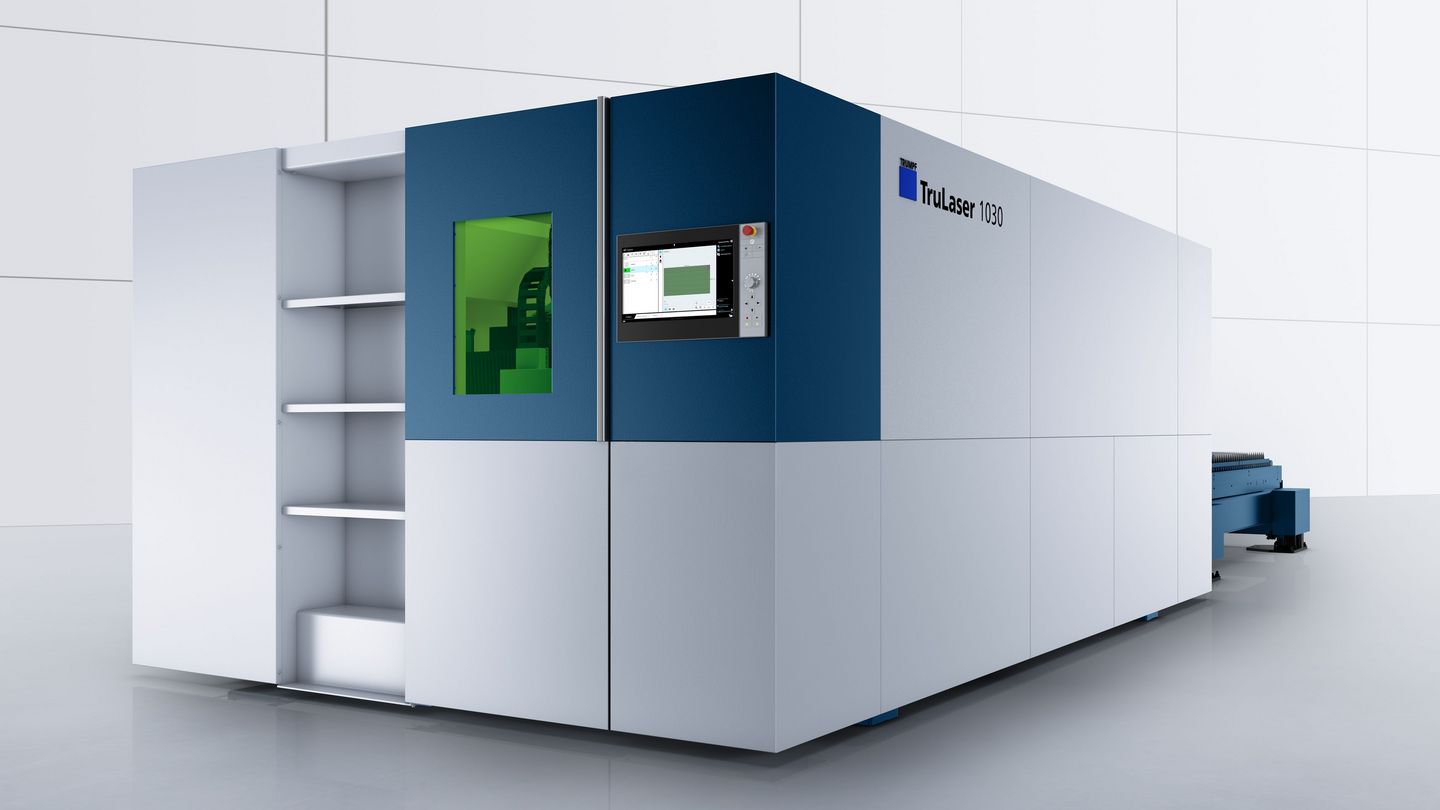

The new TruLaser Series 1000 looks like the higher classes of TRUMPF 2D lasers. Its looks do not deceive: TRUMPF equipped this line with many features that were once exclusive to TruLaser Series 3000 and 5000 models.
Collision protection
The cutting head deflects if it collides with a tilted part.
Non-ferrous metals
The TruLaser Series 1000 cuts non-ferrous metals such as copper in a process-capable way. The TruDisk laser is insensitive to reflections.
Multi-touch control panel
Automated nozzle changer
The TruLaser Series 1000 automatically changes nozzles to the correct type.
