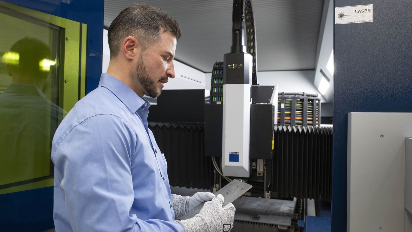

TRUMPF’s nano joint technology makes it quick and easy to break parts free from the nest. This saves time and makes life easier for workers. (Source: TRUMPF)

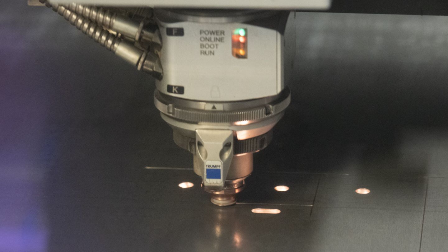

Nano joints can be produced much faster than conventional micro joints. This makes for a quicker process overall. (Source: TRUMPF)

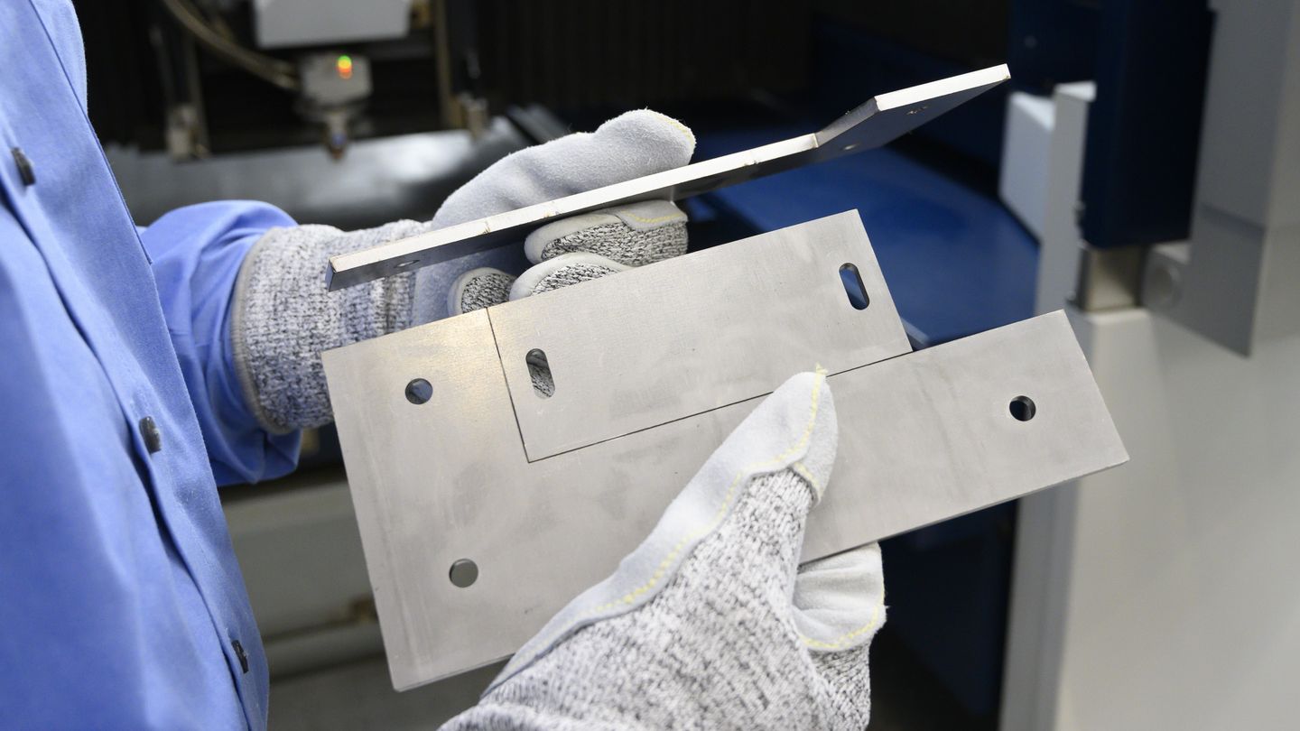

Nano joints leave a barely noticeable fracture mark when parts are broken free from the nest. This generally eliminates the need for finishing. (Source: TRUMPF)
