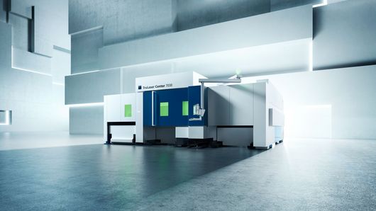

TruLaser Center 7030: The full-service laser machine
The TruLaser Center takes over the full process – from drawing through to the sorted part. It sorts both small and large parts fully automatically and does so parallel to production. You do not need to choose between productivity and process reliability because you get both.

TruLaser Center 7030 web special
Discover the world's first full-service laser machine that takes care of everything, from the drawing to the sorted part.
The full-service machine for your laser production: The TruLaser Center 7030 combines all laser cutting processes in a single machine.
