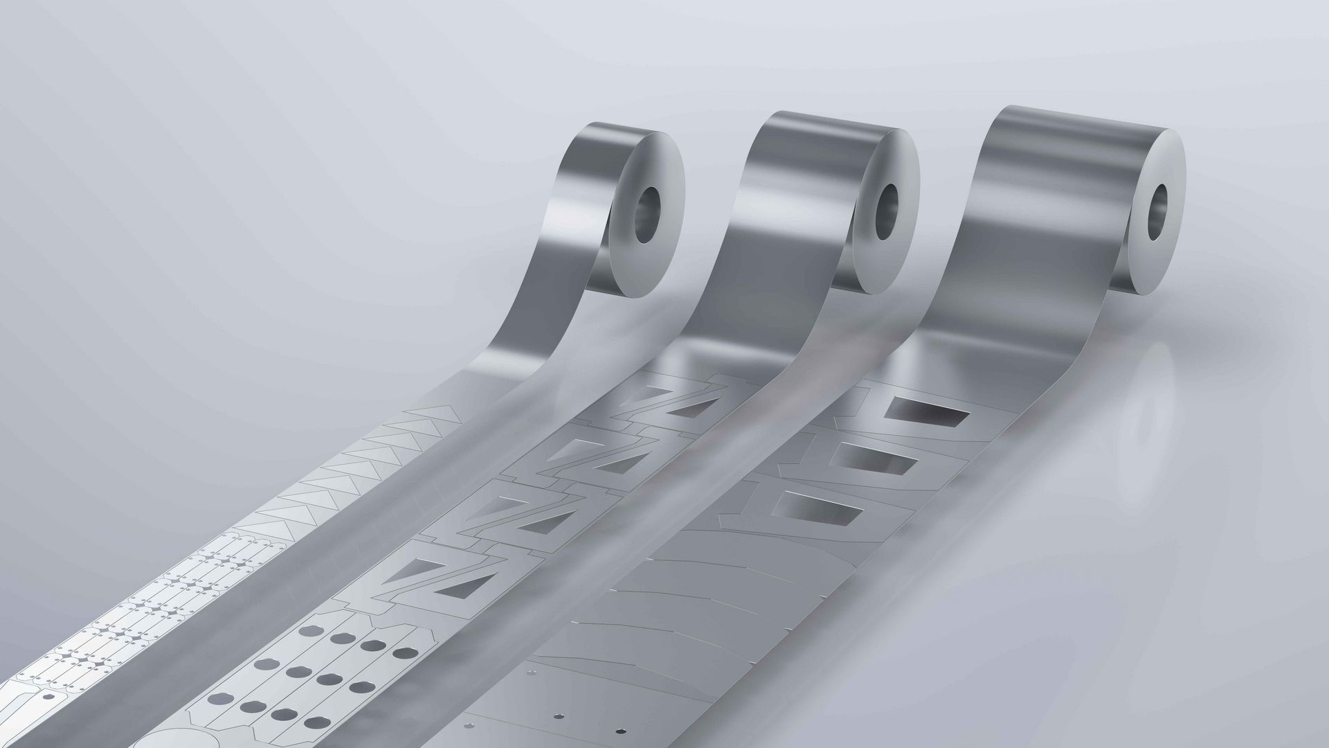

The range of variants is increasing, production sizes are decreasing: This is exactly where the TruLaser 8000 Coil Edition from TRUMPF comes into play. Sheet metal processors often use press lines for large series sheet metal processing, but have to manufacture bending tools for each new product variant: an expensive and time-consuming process. Processing with a laser directly from the coil saves time, costs and material. However, users of conventional 2D laser cutting machines also benefit from processing rolled-up sheets. In addition to higher material utilization thanks to tighter nesting and cost savings when purchasing coil material, the productivity benefits of laser coil processing are impressive.
Laser blanking
Laser cutting from coil is becoming increasingly important in numerous sheet metal processing industries – both for large manufacturers and job shops with medium to large lot sizes. But what exactly is laser blanking, and how can you also benefit from the highly productive, flexible coil system from TRUMPF?
What is laser blanking?
Laser cutting directly from the coil: The advantages
Whether you are a sheet metal processor job shop with larger lot sizes or a large manufacturer: anywhere that press lines constitute too large an investment and offer too little flexibility, but 2D laser cutting machines lack productivity, laser blanking offers simple, fast and economical production.
Save up to 15% in costs when procuring material compared to sheet goods. At the same time, benefit from up to 15% higher material utilization thanks to more efficient nesting.
Compared to a press line, changes to the produced geometry are flexible and easy to implement. Using the laser as a tool entirely eliminates the cost of bending tools, maintenance, storage and setup operations.
With the TruLaser 8000 Coil Edition, you can fully automate the cutting process – from unwinding the coil and flattening the sheet metal strip to robot-based component removal and sorting. The system fulfills all the tasks of a fully automatic cutting center.
The highly productive, highly automated laser blanking system can be flexibly connected to storage systems. Finished cut parts can be transported to other connected machines, for example for automated part bending.
TRUMPF TruTops Boost software suggests optimal nesting and separating cut strategies. This means you can depend on the highest possible material utilization and efficient scrap management. Thanks to the software, components do not get caught in the scrap skeleton during removal. This increases process reliability.
