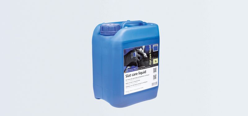

Slat care liquid & spray gun
Slat Care Liquid
Order number: 3096588
  • Made with natural ingredients. Reduces slag buildup and adhesion.
  • Apply weekly to new or cleaned bars.
  • Cutting process can be started immediately after application.

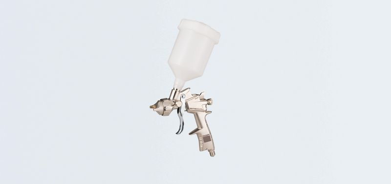

Spray gun
Order number 3095341

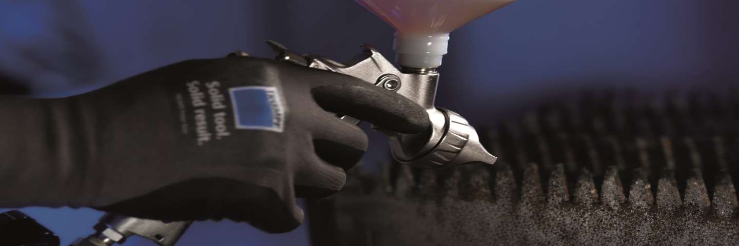

  • Spray the slats at a distance of approximately 30–50 cm and at a 45° angle
  • Simple and effective: Even application of slat care liquid in just a few minutes

Spray on
Apply slat care liquid to new or cleaned slats

How do you apply the spraying agent to the slats?
To achieve an optimum spraying result, we recommend using the TRUMPF compressed air spray gun.
