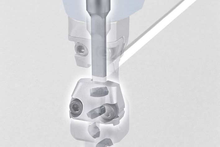

Image of the technology inside the TRUMPF slitting shears
Slitting shears
With the TRUMPF slitting shears you can cut quickly and accurately, even in curves, without the need for time-consuming adjustments.
