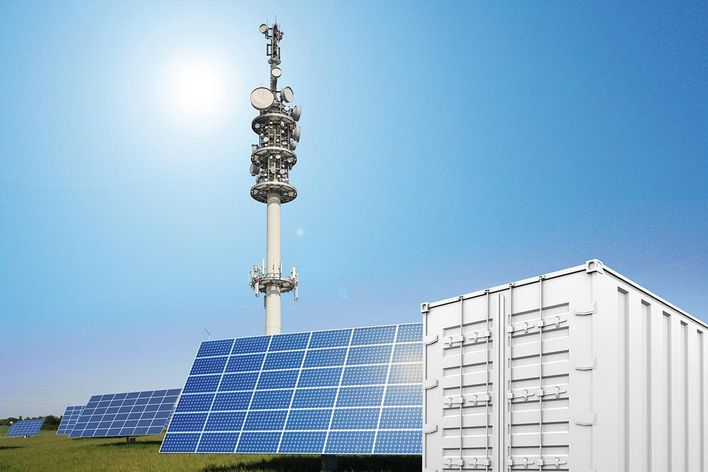

Energy storage
Energy storage for solar heating system
The volatile energy generated by solar heating plants demands the use of storage systems. In order to connect these storage systems with power supply systems, TRUMPF Hüttinger develops and delivers the heart of every solar power system - innovative bidirectional inverters. They help charge and discharge your battery system efficiently. Thanks to the modular design, they can be used in storage solutions in the most varied power classes. In addition, they can be easily integrated in existing battery storage systems and can be combined with PV plants to create a future-oriented system. TRUMPF lasers are also used for welding electrical contacts. The locally limited, low heat input ensures high-precision distortion-free seams.
